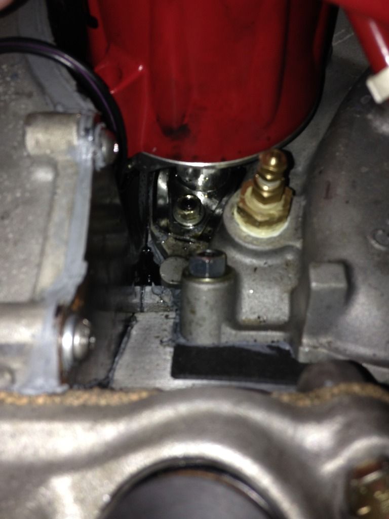

Thanks Jay.  I had some time today to do a little snooping.  I found 2 leak spots.  The dipstick tube is leaking, so I will reseal it and retighten it.  Another I found was a little worse.  There is a little "well" right next to the distributor behind the front cover.  The oil is leaking from maybe under the intake ( china wall) and fills up the little "well" and then flows down between the front cover and drivers side head to pool up ontop of the oil adapter.  Seems like at anytime, there is a tablespoon of oil sitting in the "well".
This doesnt explain the rear oil drip (bell housing) but getting them found a little at a time.  Not sure if this picture is that clear, but its the beat I could get with my phone;
