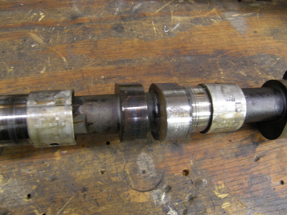

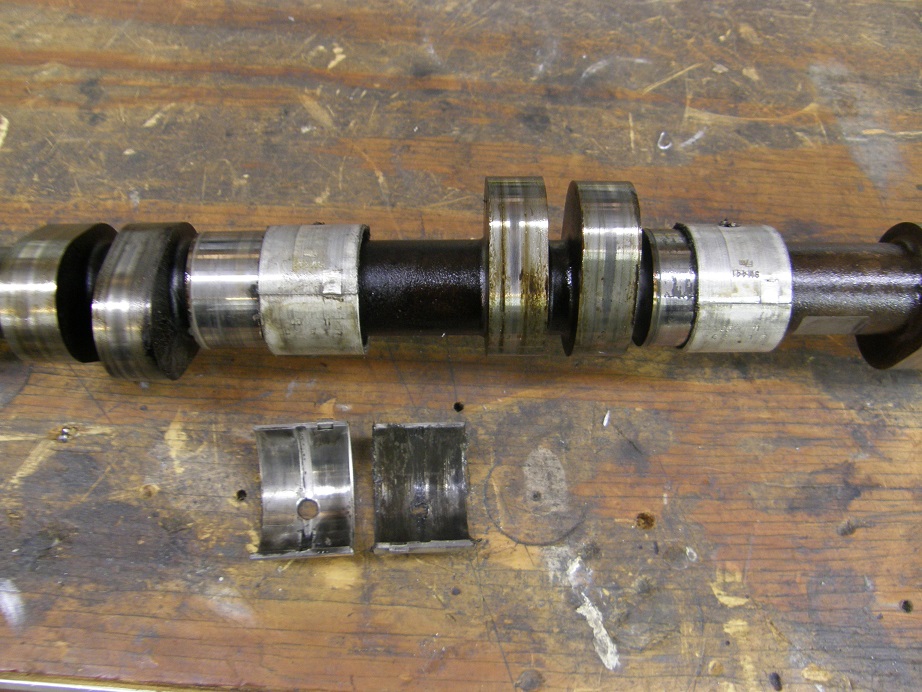

Jason gave a really good description of what I found; the cam bearings (in the block) were the culprit.  I was quite surprised that the standard FE topoiler bearings were in the engine, and not the sideoiler bearings; a regular 427 sideoiler wedge FE would have burned up the valvetrain too if it had been fitted with those bearings.  I was also surprised that some of the cam bearing shells were welded together; man it must have been hot in there!  The ones that did come apart were toast.  Here's some pictures:
After I got the stub cam out I looked into the cam tunnel and thought I could see that the #3 cam bearing had the hole in position to line up with the oil passage in the block.  Since there was no #3 cam journal, this was a problem, obviously.  After I got the crank out, I confirmed this issue:
I also noticed that the main bearings looked funny, with shiny spots in some areas and no visible wear in others.  Pretty sure that this is the crank; the bearings are std/std, and those RPM cranks are notorious for taper and out of round issues.  So we'll get the crank ground 10/10 and use oversize bearings.

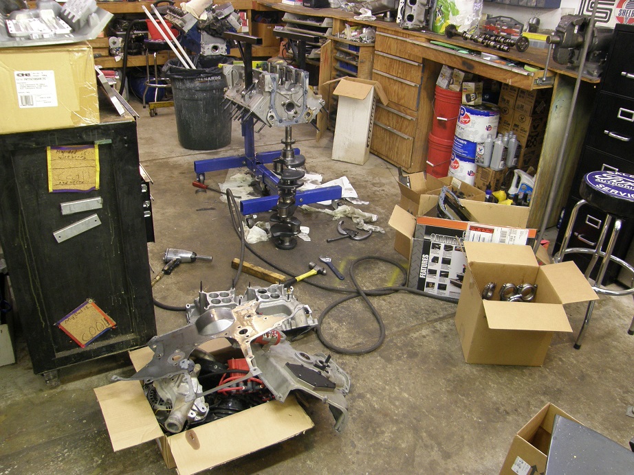

Really the only thing left to do is to disassemble the heads and look at the valves and guides; hopefully they are OK.  Then its off to the machine shop with the parts.  Here's a picture of my shop after the disassembly process.
Time for another cleanup LOL!

Jay - Are those iron cams?  They don't look like the new billet ones I've seen.
« Reply #1239 on: October 19, 2015, 03:47:12 PM »
There is some evidence of copper cladding left on the ends of the cams, Bill, so I think they are billets.  I will have to look again to be sure...
