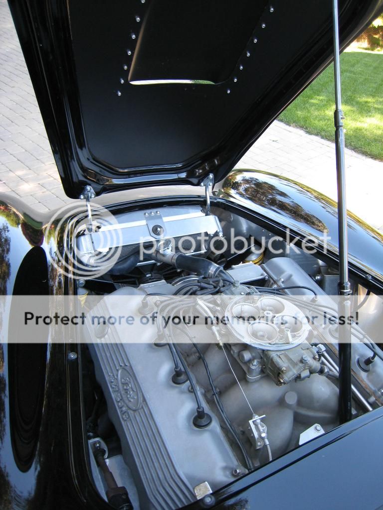

« Reply #1019 on: June 09, 2015, 09:05:32 AM »
How in the world does that thing stay cool with the tiny Cobra radiator?  It looks like a 4 row (just from the thickness) but surface area seems tiny!  What temp does that idle at?
Jason
