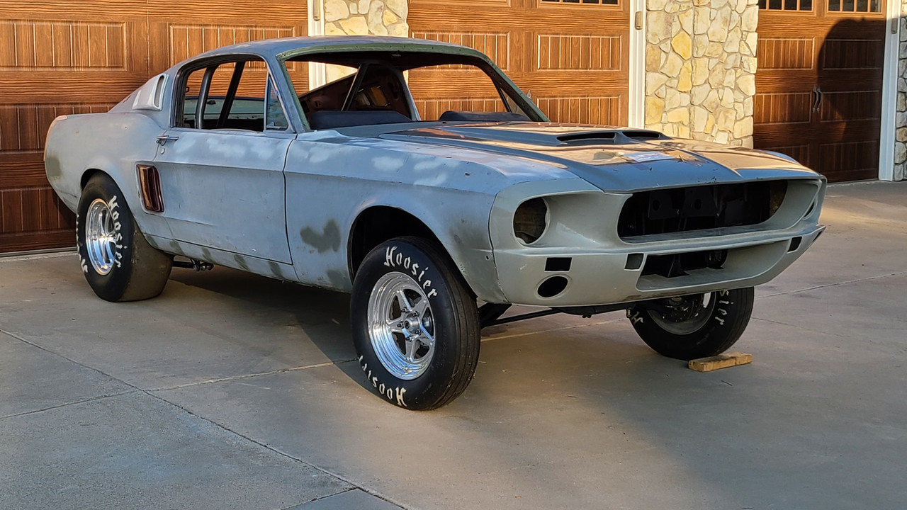

Car is finally ready for paint but I can't find anyone at a reasonable price. Maybe because I'm older I still think it can be painted for less than 10K.
Most shops I went to only want collision repair insurance work and the ones that do full car paint all acted like they produce show cars. I feel a car I'm going to race should be daily driver quality,
a show paint job is for trailer queens. Wish I had the time or knowledge to try it, Jay's sure looks nice. This is about as far as I can get it with the ill fitting fiberglass reproductions.

Sweet!!  Where are you at? California or Arizona right? What colors are you thinking?
Still in California, looking at Arizona but I think I’m going to be here a while longer.
On my computer at work I have pictures of a red, 2 blue, white and 2 green Shelbys. I’m leaning toward blue with white stripes.
