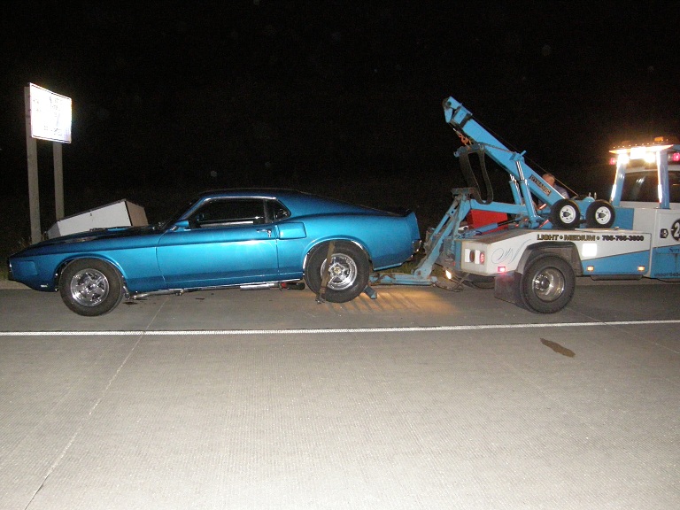

Finally we were ready.  The car started right up, and we were off going east on I-70.  But the oil pressure just wouldn't hang in there.  It started off at 60 psi when we got on the freeway, but gradually dropped.  When it got down to 20 psi and I started hearing valvetrain noise, we pulled off on the next exit.
I put my AAA card to use and within 45 minutes a tow truck was there.  He couldn't take the trailer, so we pulled all the real valuable stuff out of it and chained it to a roadside sign; we will pick it up this morning after we get the truck and trailer out of impound at Heartland Park.  (I hope no one steals it tonight; I don't want to lose The Pipe Dream.)  The tow truck hooked us up by the back wheels and took us back to the hotel in Topeka; here's a photo of the car on the hook:
So, the epic thrash ends in an epic fail LOL!  Somehow, though, I just don't feel so bad about this one.  I knew it was a gamble going in, especially the part about the internal water leak.  In the end that's what got us; we successfully addressed all the other problems that came our way.  I was glad to see all my Drag Week pals, and the car got a phenomenal reception at the event; everybody liked it.  And now I have another whole year to improve this program, and bring it back with a vengeance at Drag Week 2012.  I can accomplish a lot in a year...
