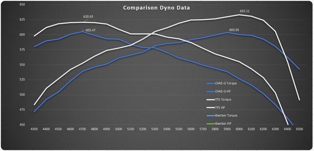

I also have some corresponding dyno data. 465" Engine with the EMC heads, and also out-of-the-box TFS heads.
Only disappointing part of the TFS heads is they hit a wall around 6200-6300
picture hosting
I'm wondering what you had going on there.  Maybe it was an issue with that particular pair of heads?
Here's a 449 that I did with out of the box TFS heads:
Here's a 465 that I did with out of the box TFS heads:
Neither had a problem with rpm, so I'm wondering maybe if your heads had a port/valve job issue???
I do know that when I do a hydraulic roller with these, the setup has to be *light* in order to get them to pull on up.
Regardless, as you have shown, the amount of off-the-shelf performance that you get for $2600 is awesome.
picture hosting

I don't want to lump anything all together in a general statement but different heads most likely will always require different cam specs.  In Mike's dyno results, it could be that the cam favored the TFS heads, or it could be that the cam favored the C4 heads.  That's something you don't know unless you do a ton of camshaft testing in situations like that, then you can almost get into a perpetual rabbit hole of variable chasing which will wear you out pretty quickly.
The amount of overlap brings up a good point.  Tighter lobe separations may help the bottom in certain combinations, but the LSA is not the only thing that controls the amount of overlap.  The advertised duration has as much say in the overlap as the LSA does.  I can have two cams:  278/278 @ seat, 240/240 @ .050", 110 LSA and 270/270 @ seat, 240/240 @ .050", 106 LSA and they will both have the exact same amount of overlap.  Will those cams behave the same?  No, and it's not because of the LSA number, it's because of the more/less aggressive lobe of each camshaft.

All of these examples posted are all different combos.  Just looking at where peak torque happens on each one, you can conclude that Mike has the smallest cam, and Mr Woody has the biggest one. Curious how many of these engines had a dual plane manifold……..that also can affect it.  If the cam isn’t big, and the engine is, it will run out of plenum past peak and taper off.  The strength of the dual plane is it will have nicer power where you want to drive a street car.  Happy and peppy below peak torque.

I should have done a more thorough job explaining the dyno data that I posted above. The engine is a 465" engine built by Blair (.040" over 428 block). Originally with Blair's EMC C4AE-G factory cast iron heads that were ported in that same fashion that his engine masters engine was. My '62 Galaxie was the intended recipient of this engine, but as things go, plans changed. The engine was sitting at my place and we needed a dyno mule so we swapped the 465" engine with TFS heads and also some other pro-port heads that we had laying around. Our intent is to also swap on our MR head after its 100% complete, but this has been a long drawn out process and hasn't happened yet.
The heads had beehive springs on them. Sorry Ross I didn't catalog the spring data well enough to be able to tell you here from my computer, I'd have to get back to the shop and put them on the spring tester. I understand your sentiment, you think it was valve float? We fooled around with springs a bit to make sure that wasn't the case. I assure you it wasn't. The discussion above between Blair and Brent makes the most sense as to why the TFS heads didn't want to make it past 6200 for us.
The 465" engine has a performer rpm intake on it, mildly modified. Intake divider cut down a bit and the plenum is blended. The cast iron heads were run with the same intake as the TFS. All conditions kept the same except heads.
The engine is around 10.5:1 compression. Normal dyno headers. Nothing crazy for the bottom end. I think the only bit of trickery was in the cam. It's a shorter lift cam and shorter duration but sure seems to have steep ramps on it. Almost like a stock class racer built it. Solid roller cam.
I suspected float less than bounce, and given added info of a steep lobe, thinking more maybe bounce.
That being said, just bench racing, but typically what I see from a head is flattening out, not losing it's mind like that :)
