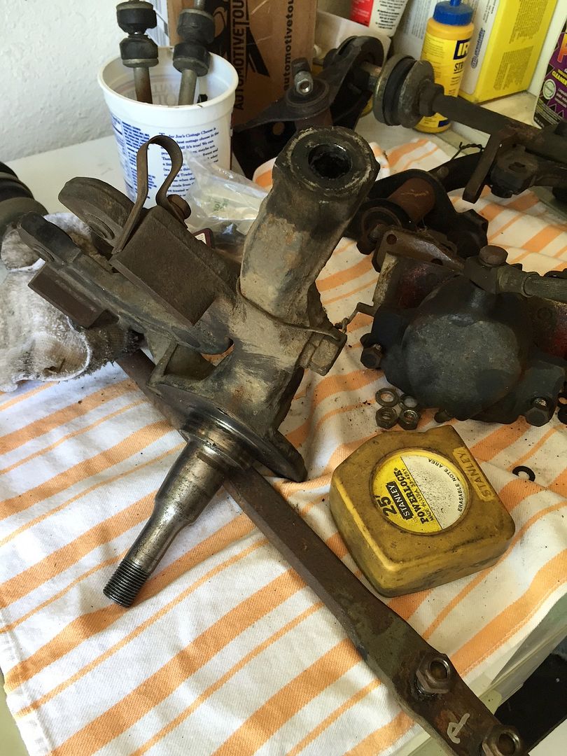

BTW will you Fairlane guys take a look at these pieces.
When I pulled the front end apart these are what came off.
It doesn't look like stock Fairlane stuff to me.
For one, I thought the calipers should be dual piston.
Re: Giggling like a school girl
« Reply #79 on: June 24, 2015, 03:18:27 PM »
Think I have it figured out.
I think it's '68 stuff.
« Reply #80 on: June 24, 2015, 03:45:36 PM »
Yeah, it should have had 4 piston "fixed" calipers.
