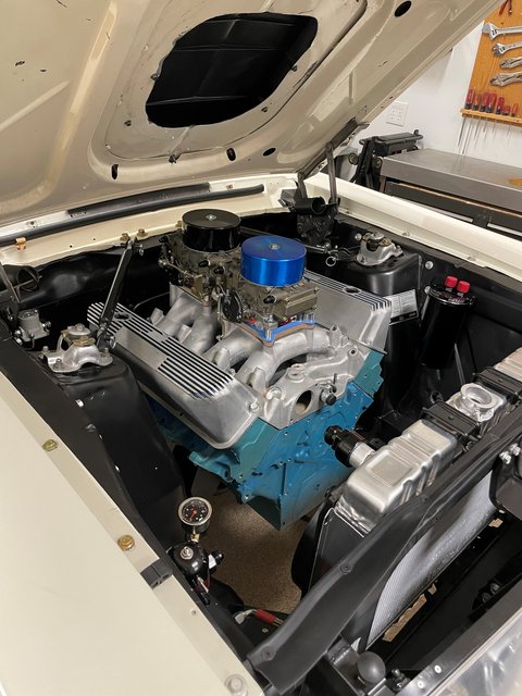

Carbs fit under that scoop?
« Reply #101 on: February 28, 2022, 04:57:04 PM »
They fit perfect! Tunnelport intakes are shorter than you would figure, within a 1/4" height of a medium riser 2x4 C7ZX intake. I need to make one small cut in the back of the opening because the rear vent tube touches it. The hood wont go down with those blue and black carb hats on there.
