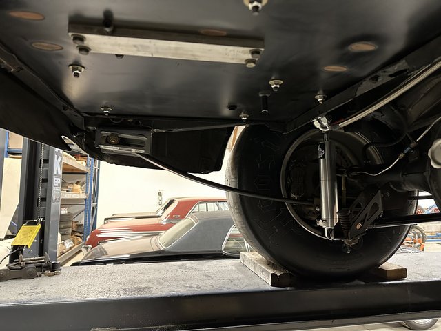

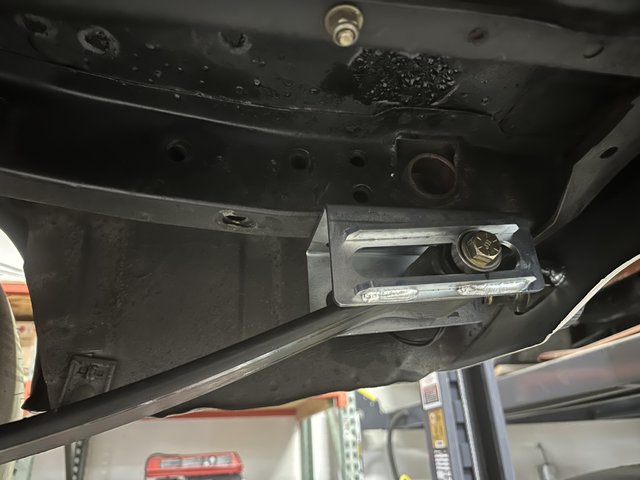

The downtime has allowed me to make some modifications to the car and to take care of some maintenance. I shipped the brakes off to TBM this week to have serviced. Funkhouser Racecars makes Cal-trac lower brackets that relocate the shocks, I got those installed and made some frame mounting points. I have Viking double adjustable shocks on the way to replace the Calvert gas shocks. I'm kicking around the idea of installing a rear anti roll bar, but that's only if we're dealt even more downtime.

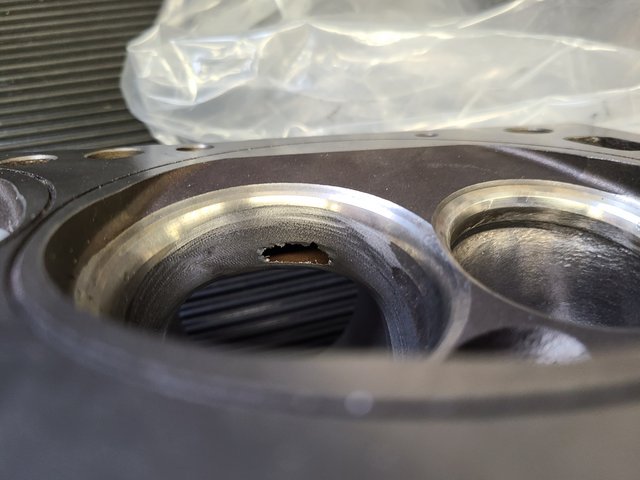

Mike, as the saying goes "if it wasn't for bad luck I would have none at all". The heads were ported and showed great flow numbers, we were very thrilled to get the engine going. Our friend John digitized the ports and CNC'd the rest of the ports. WELL, out of 8 holes, 1 of them got into a water jacket. That deflated us quite a bit. We didn't want to send another head out there and potentially ruin another very expensive tunnelport head.

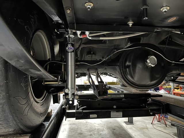

New shocks and leaf spring sliders are complete now. I'm starting to run low on miscellaneous to-do's. I might install my dummy block and mount up the trans so I can handle trans cooler stuff next.

« Reply #115 on: October 27, 2023, 05:30:51 AM »
With the new Vikings the piston looks like it is pretty much all the way down at ride height.
Compared to the Calvert shock which show the piston about halfway in the tube .
I don't see that you would have much if any travel.
Is there something I'm not seeing?
« Reply #116 on: October 27, 2023, 08:08:50 AM »
The downward travel of the suspension is very limited. I still have about 1" of adjustment on the lower brackets that I can lower the body of the shock down and extend the shock out if necessary. I was going to wait until the engine and trans are in the car to see how all this stuff shakes out.
With the Calvert bars, when launched the rear end will separate from the body. So 80% of the shock movement is extension.
« Reply #117 on: October 27, 2023, 08:10:33 AM »
Also, in the above pictures, the suspension was in full droop with the calvert shocks on it. I only set the shocks up to have about 1" or 1-1/2" of shock showing at ride height.

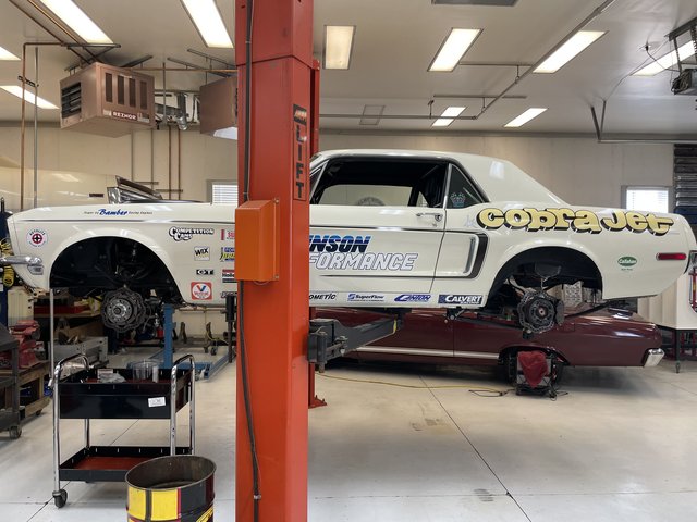

It's been a bit since I've put much effort into the race car. I decided a few weeks ago to complete an engine. I had been waiting on our new head castings to come out and put on this short block, but made the choice to put a normal set of edelbrocks on it and will switch them out when our castings are here.
Here's some of the progress as of recent.
-Engine is together, waiting on a torque converter now, then I can drop it in.
-Rear leaf sliders are installed
-trans brake is figured out
