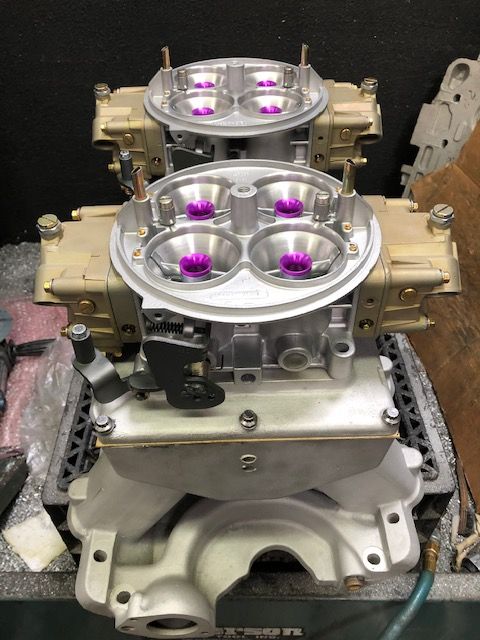

All was well and good until Geoff said, " Do me a favor.  Don't die with that tunnel ram that you've had for 20 plus years still sitting on your shelf. How about using that thing and let's see if we can make 1,000 hp with it?"
I'm a sucker for a challenge .........
And so it began ......
We've been working on things for the past few months with cam selection, carbs getting rebuilt and all the rest.
We've challenged ourselves to see if we can make 4 digits at 7,200.

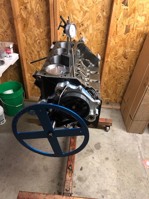

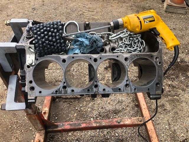

This rebuild started out so simple that I used a ball hone on the block:
I heated some Napa 10-30 oil up to 200* for the job:
We put new cam bearings in it and got some good rings from Akerly and Childs. I screwed up on the end gap and gapped the stainless top .043" ring at .041" as if I was going to run my 350 shot on it. It didn't beet that much. .035 would have done it.

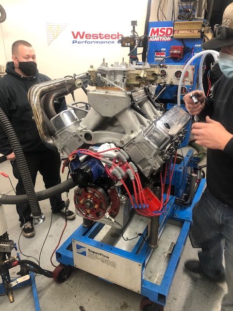

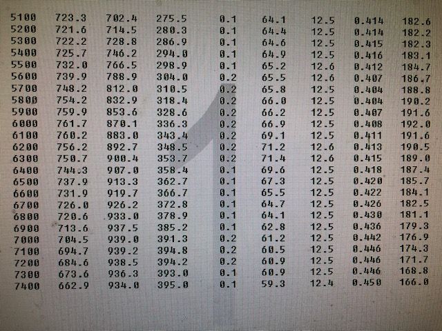

We made it up to Westech this past Thursday with both the single 4 and the tunnel ram and burned some Sonoco 110.
The single 4 made 939 hp at 7,200:

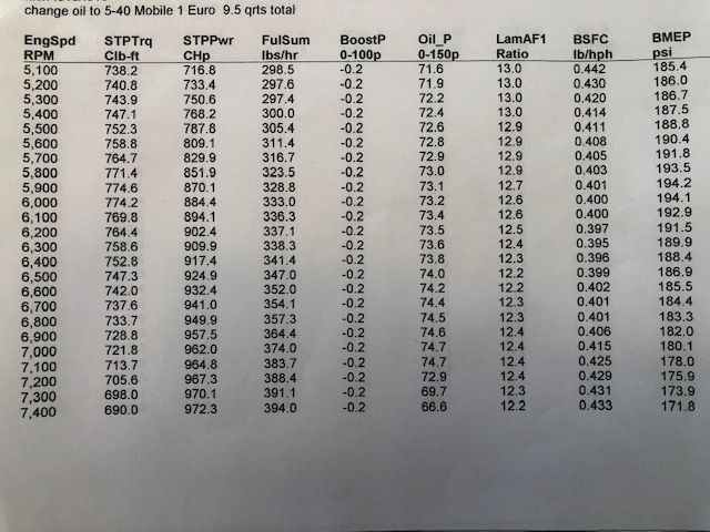

The tunnel ram made 972 hp at 7,400:

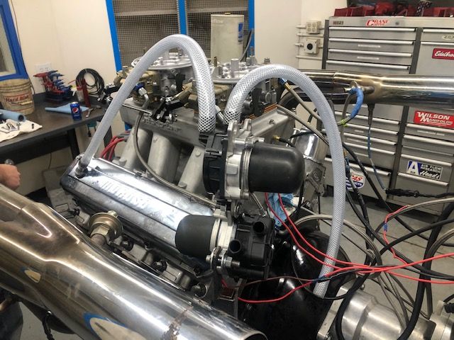

We were running a little Ford Taurus electric vac pump on the engine:
It  pulls -4" static and was able to maintain -1.5" thru 7,400 rpm with the single 4.  When we put the tunnel ram on we let the silicone set up as we ate lunch and then were running the engine without the vac pump turned on and on the 3rd run it blew out the rear China wall seal.  We then turned on the vac to control the oil leak. It was able to pull -.5" vac thru most of the run, but went to  positive .5"  at the end of the runs.
We're going to do some work on the tunnel ram, install a GZ vac pump, advance the cam and head back to the dyno in a couple months. ... Might even take some Q16 with us.  We'll see.

I'm curious about the injection pump used as a vacuum pump. I get that you're using the vacuum side, but how did it pull negative pressure with the china wall seal blown out? Did you reseal it with silicone first? Otherwise, pulling any vacuum would have been impossible.
How much pressure does an engine typically make during a pull, without a vacuum pump? Those numbers seem pretty good for using a pump obviously not designed for the task.
Also, I notice it says "change oil to 5-40" on the tunnel ram sheet. Were you running thicker oil with the single 4? Just curious as changing to thinner oil would account for a few horsepower. Still, the ram picked up all across the board.
JC-427Stroker
  • Posts: 96
The pull that made 970+ was pull 22. The oil had been changed many pulls  before with the single 4 still on.  Over the years I've changed the oil on the dyno many times and picked up anywhere from 8-15 hp using Mobil 1 over "dino" oil I changed out.
We were able to generate the vac by stuffing a couple of wet oil soaked paper towels up against the china wall and a couple of shop towels on top of them.  Instead of pulling the 3.8 -4" static it was able to pull almost 2.5" static. It then dropped to .5 during the run. I read somewhere that those little pumps only move about 5 CFM, but I can't verify that number.
 I've been told by people who have used the pumps for quite some time that if you want them to live on a car you should definitely place an oil separator inline before the pump and remove the foam filter that's inside them. If you don't remove the foam they will be oil soaked and kill the pump in a short period of time.

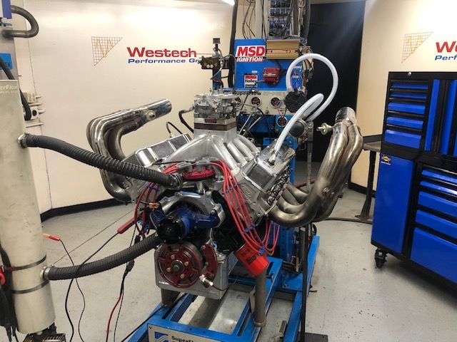

Here's a Single 4 run. 940 hp 7,100 Vac pump pulling 1.5".
Lower left on screen second window over from the left is crankcase vac:
 https://vimeo.com/530885705
It might be worth noting that the ring gap on the .043" stainless top ring was set at .041"
Light (10 lbs) oil ring.
What I was thinking too.   They would not care to swallow any oil IMHO.  That should be doable.
