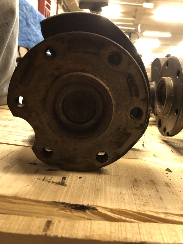

I’m not totally disagreeing with what Richard said about the crank flange, because he properly hedged it, but I’m going to expand on it. I see this on the internet all the time because people think they’ve found an easy I.D. tip. You can NOT positively identify the stroke or size of an assembled FE by looking at the crank flange. The “half moon” thing only applies sometimes, and unless you know for sure the engine has never been rebuilt, and the model year you’re looking at, you just can’t be sure what you have without checking the I.D. number on the crank or measuring the stroke.
If the engine has been through a mass rebuilder, or a previous owner did a rebuild with an exchange crank from a local crank grinder or auto parts retailer, there’s no telling which crank is in an assembled engine.
I’d hate to see someone pass on a good FE because they followed that “internet” tip.
Here’s a C1AE-A 3.78” stroke crank, it has a half moon cut out and a notch.
Here’s a C4AE-B 3.78” stroke crank, it has a half moon cut out and a notch.
Here’s a “2TA” 3.50” stroke crank, it has a half moon cut out and a notch.

« Reply #10 on: March 12, 2021, 02:59:04 PM »
Kevin is there any difference in the size or depth of the half moons,if there is that may be an indicator since it is the path for the boring tool that drills the the throw of the crank.If the bored hole in the throw of the rod journal is centered in the journal it stands to reason that a longer throwed crank would have a smaller/shallower half moon.

I took the pictures of the C1AE-A & C4AE-B cranks last summer, they weren’t mine and have since been sold, so I don’t have them handy to measure. I did look at that last summer next to the 3.50” stroke cranks, and it looked pretty much the same, but I didn’t measure because they seemed close enough that with a casual glance at the salvage yard it wouldn’t have helped. The point is that the “half moon” thing alone won’t help. Maybe if someone has some early 3.78” stroke cranks they can check. I know the angles of the pictures makes it hard to compare.

It does, you were probably seeing the same thing I was,I was trying to compare how far the half moon came down in relation to the bolt holes but the different angles made it tough.Frome the pictures it looked like the 2 390 cranks half moons didn't reach down as far in relation to the bolt holes.

Ok went out a and did a little checking and blew my theory out of the water,the lightening hole drilled in the last throw is not centered in the rod journal so will have no effect on the depth of the half moon,also took calipers to a 64 352 crank an  C1AE-A 390 crank and the half moons appear to be identical in depth,so looked at a 428 crank and noted that it has a notch and a drilled hole in the flange,then looked at a later 2U 390 crank and guess what, it also has a notch and a drilled hole,so based on that I don't see how the appearance of the crank flange can be of any help in identifying the stroke of a crank like chevrolets.It appears that most earlier cranks used the half moon and notch ,while some later cranks used a drilled hole and notch,it does appear that some of the later 360 2T cranks still used the half moon.So lacking the ability to turn the engine over and measure the stroke ,your stuck pulling the pan unless you have a borescope that you can stick in the drainplug to check the counterweights for bevels and all that does is eliminate the 3.5 stroke crank,it could still be either a 3.78 or 3.98 stroke crank.This of course only applies to stock cast FE cranks,forged 427 or FT cranks are another matter.
