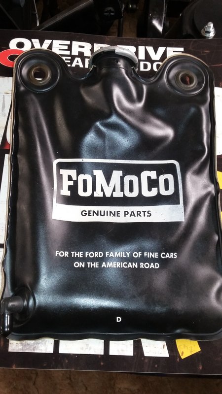

Re: My Mustang needs a radiator overflow tank. Would like an OEM look.
« Reply #3 on: March 07, 2021, 10:47:30 PM »
I wanted to keep a somewhat factory appearance as you, so I repurposed the factory washer bag as my overflow. I capped off the fitting in the bottom of the bag and added a mini zip tie to make sure it doesn't come off. I also drilled a 3/16" hole for a vent in the top of the neck and drilled the cap to accept a grommet for the tube. I ran out of time last year to install my custom bent 5/16" hard line(brake tubing) from the rad. to overflow. I just ran a piece of clear nylon tubing to get it going. The tube does reach to the bottom of the bag, to make it recirculating. I am running a Ford Racing 16lb cap.

Nightmist66/Jared:  That is a beautiful engine compartment, true to an OEM look. Well done. Clever idea to use the washer bag. Hope the hot water does not distort the rubbery bag. However, my '68 Mustang has a white plastic washer fluid tank that I would like to keep.

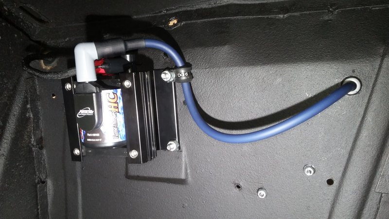

Question: Where did you hide the ignition coil on your Fairlane?

  I have used the '68 windshield washer "bottle " as already suggested . Very simple and very stealth .
Clark
Thank you, Clark. I haven't had any issues yet with the bag, but I only have around 500mi on this new setup. I mounted the coil right behind the washer bag on the inner fender. The new style coil wasn't going to match the period-ish look that I wanted, so I decided to hide it. I also have an accusump behind the front bumper.
