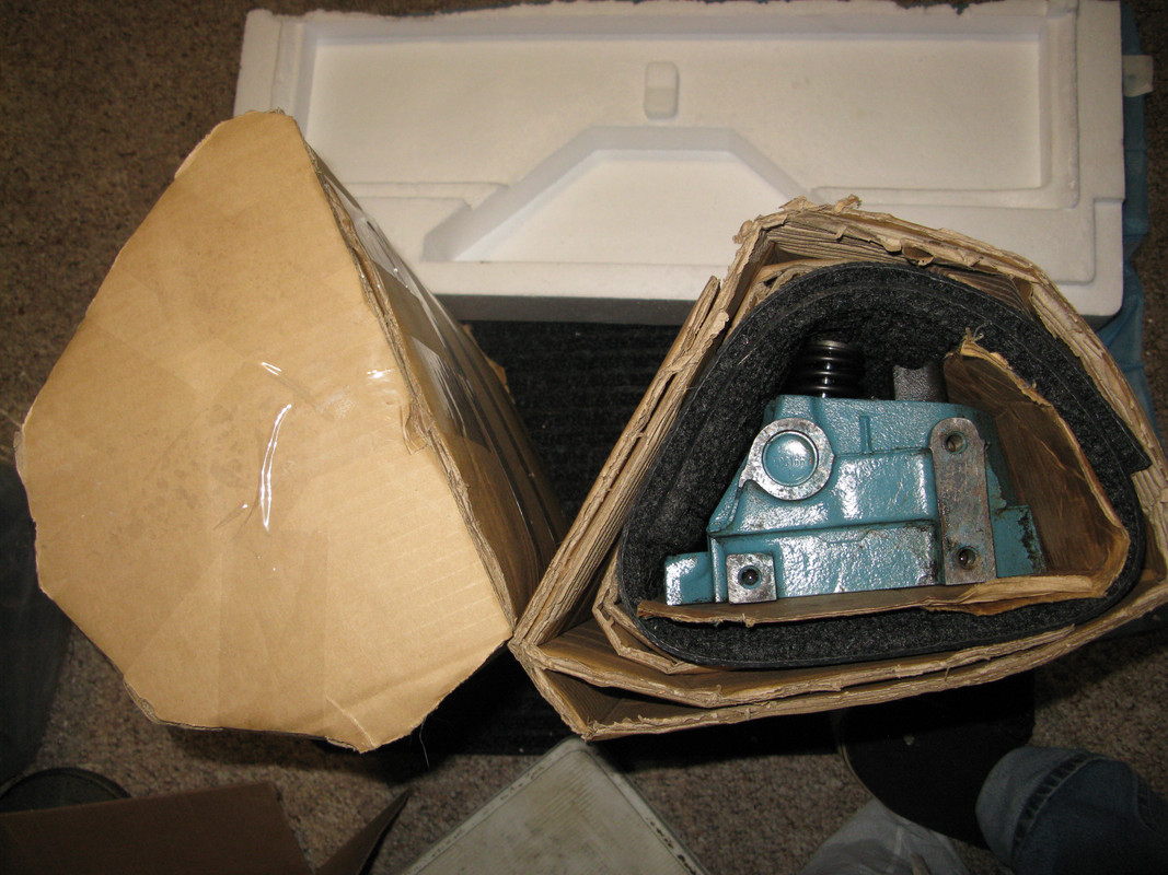

Lookin for new ways to ship complete FE heads, springs an all

Ricky , I roll mine in carboard. Then find a box that is snug fitting to the already rolled head. box it up each head separate. I have never had a issue doing them this way. Thanks Lance

I make mine so heavy it drives the shipping up

I have a lighting fixture store 5 miles from me. They have long skinny boxs that the fixtures come in. Perfect for heads.
They are fairly heavy cardboard and about 8 feet long.
I wrap each  head  in bubble wrap and insert in the part of the box cut down for one head and make a cap to cover the end.
I do both heads this way.
No problems so far.

I wrapped the heads in heavy duty mats, then 2 layers of heavy cardboard with 2 layers of foam in the ends
10 lbs of wrapping each head ..lol .... only added $5.00 versus a bare head

 Cardboard pour tubes for concrete work great for shipping heads.

Yep, heavy cardboard Sonotubes (TM, for trademarked, I think) for concrete pours work very well.

I have received heavy parts like finished heads bolted to a piece of 1/4 particle board and then inserted into a carboard box. Gives is a more stable base that won't shift or crush due to weight. Granted the wood adds some more weight.
