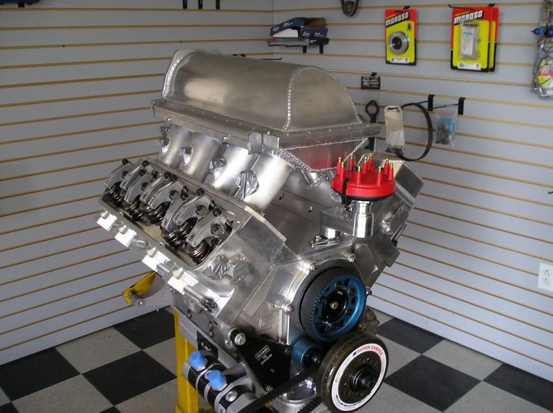

What ever happened with the billet canted valve heads? Jay, did you ever think about casting off that design? Now a cheaper version is what I want!

Too far from a normal FE for me.  FE valve covers won't fit, intake doesn't have the valve cover rail in it, etc.  Besides, canted valve heads mean a bigger chamber (which isn't good), and you can get the same effect as canting the valves by just raising the port (which is what I did on my heads).

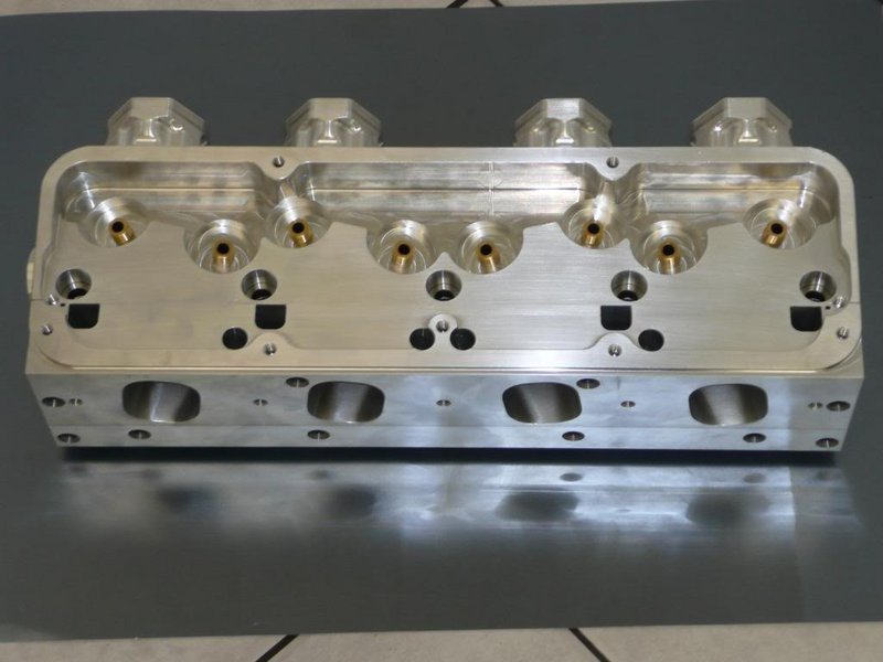

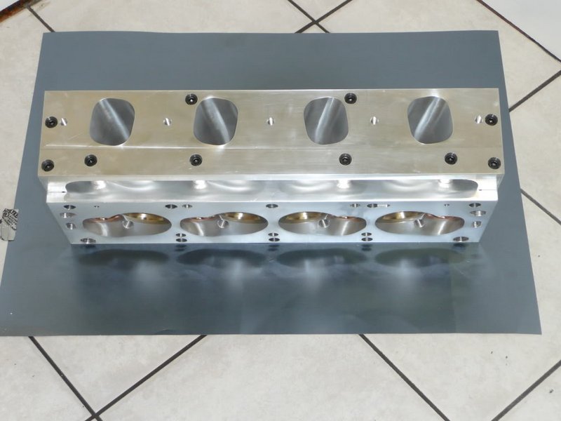

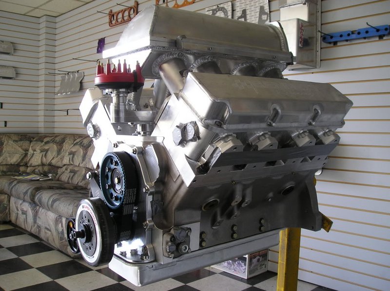

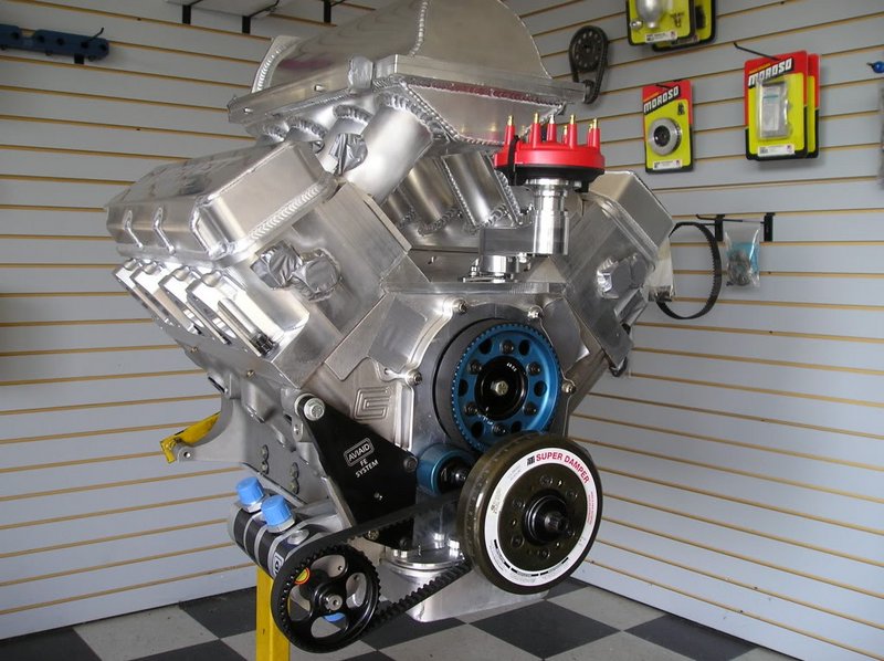

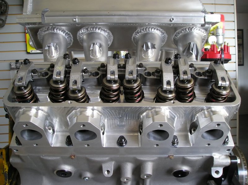

A few more pics I found:
