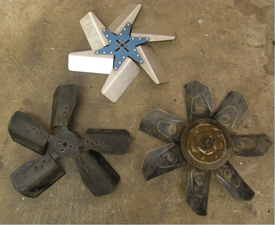

Further searching at my place on Saturday night yielded the Mustang fan shroud to fit the radiator, so I didn't need the fan shroud I got from JC.  Here is a photo of the three fans that I tested today:

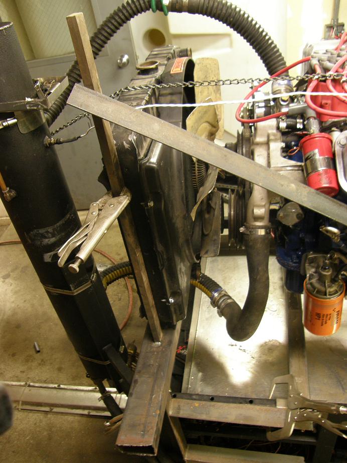

The next task was to cobble together some kind of bracket arrangement to hold the radiator and fan shroud in place in front of the engine on the dyno.  I bolted the clutch fan up and used that for fitment purposes.  Some angle iron, some square steel tubing, and some steel straps were tack welded and vise-gripped together to get the radiator and fan shroud into position.  Unfortunately, the fan shroud was just a little small in diameter for the clutch fan, so I had to sneak the fan right up next to the shroud, but not inside.  I was really close though, less than a quarter inch away, so I don't think this had a significant impact on the test.  Here's a couple of pictures of the radiator and shroud mounted on the front of the dyno stand, with the clutch fan installed:

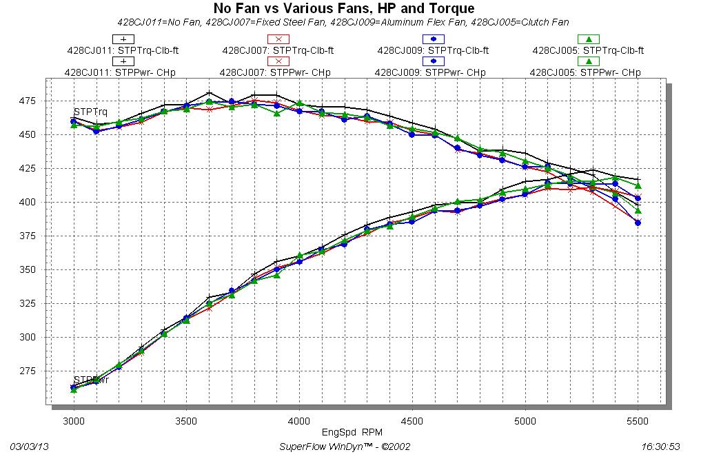

Next up was the aluminum flex fan.  These things have been sold for years as horsepower improvers, because supposedly the blades will straighten out at higher speeds and save power.  My testing did not show that; the aluminum fan was only marginally better than the fixed blade steel fan.  Here is the aluminum fan in comparison to the clutch fan:

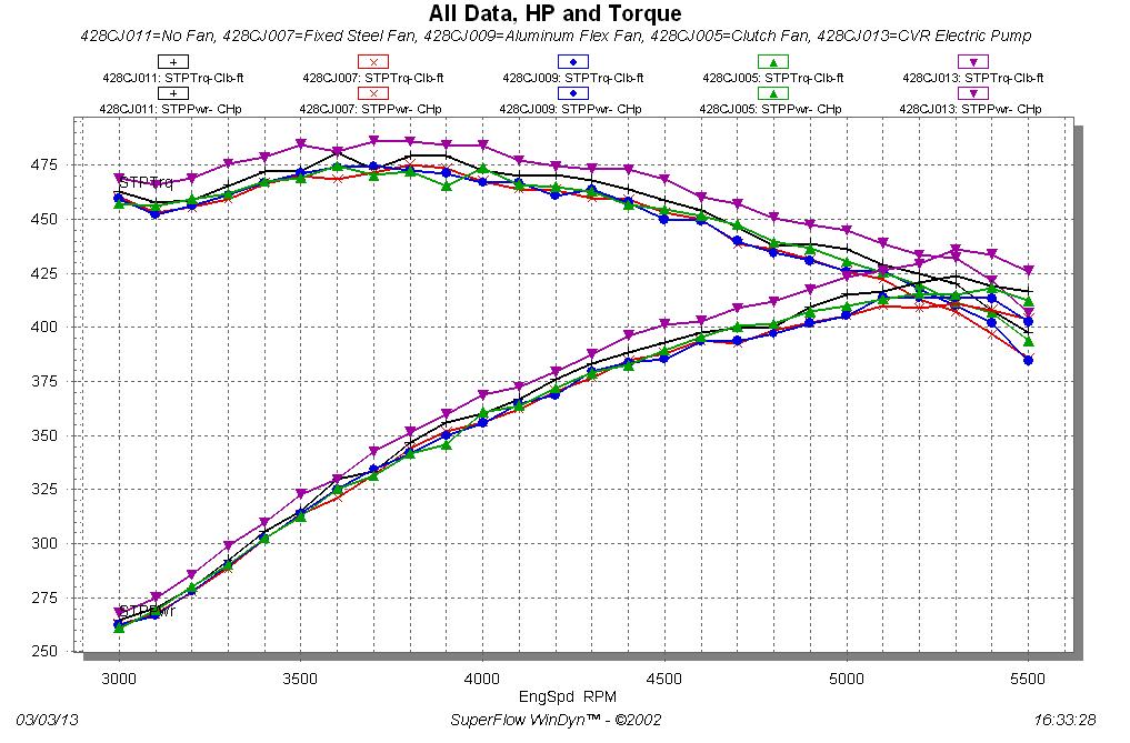

Next I dismounted the radiator from the dyno and removed the aluminum fan, and ran the engine with no fan on the water pump.  Made the same 425 peak horsepower it always seemed to.  Here is data from all four of the tests on the same graph:
Finally, I pulled off the Edelbrock pump and put the CVR pump and my adapters back on the engine.  I was expecting a significant improvement, which I got, but it also appeared to be an improvement across the entire powerband of the engine, not just from 3800 on up.  That was good news.  Here is the previous data with the CVR electric pump added:

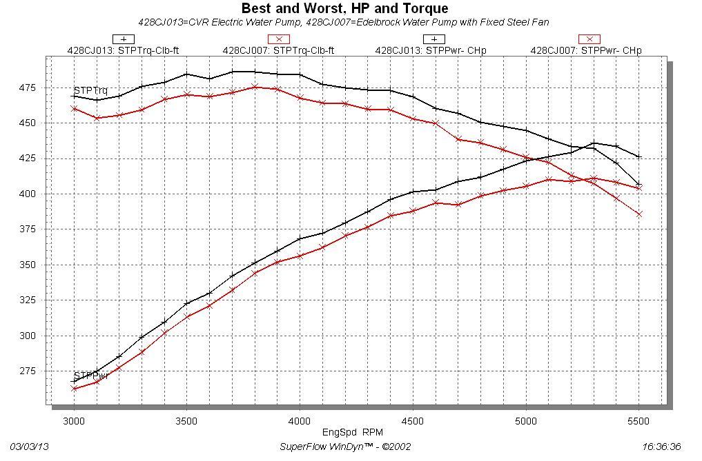

Just for grins I plotted the best and worst power pulls, which were the CVR pump and the Edelbrock pump with the fixed blade fan.  There is a pretty significant difference here:

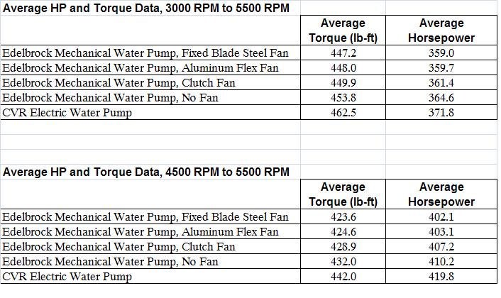

I also calculated the average torque and horsepower across two engine speed ranges with this data.  The first table in the picture below shows the averages across the entire 3000-5500 test range, and the second table shows the averages from 4500 to 5500 RPM, where they are more pronounced.
So I think it is fairly safe to conclude from this testing that switching from a mechanical water pump and fan setup to an electric pump and electric fans will free up about 20 horsepower.  Based on this testing I find Car Craft's results hard to believe, unless there is something about the fans that they tested that caused them to really soak up the horsepower.  Finally, it is worth noting that this test was not performed with the car running at speed, and it seems to me that this may affect the horsepower loss results from the fans.  But since I can't accelerate my dyno down the drag strip, that result will have to remain a mystery ;D
