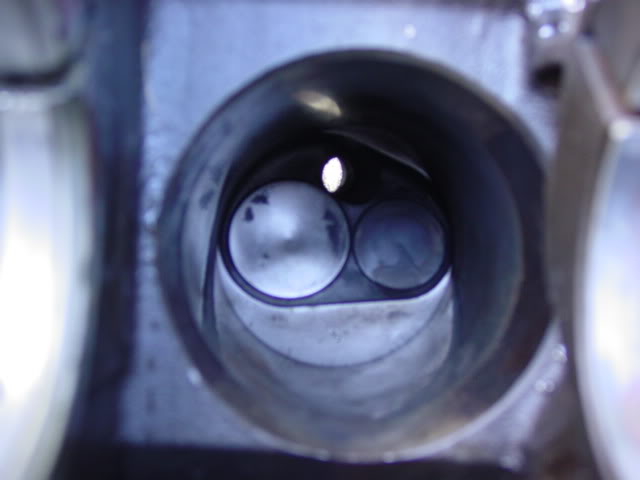

Here is a picture of when a 1.67 exhaust contacted the wall of a standard bore 390, as you can see , physically impossible to happen in an assembled motor.  Intake had a ton of room with a 2.15 valve.  That's a different head and valve size, but the exhaust valve is .06 smaller but the bore is .105 smaller
If I were you, I'd set a head on and look, and even better clay it up for radial clearance after.  Might not have to spend any money

Thanks for the information and pictures guys. Ross the math definitely says it should easily work. Clay is a good idea, also hoping my cheap phone boroscope will fit through the spark plug hole to have a peak at projected max lift.
