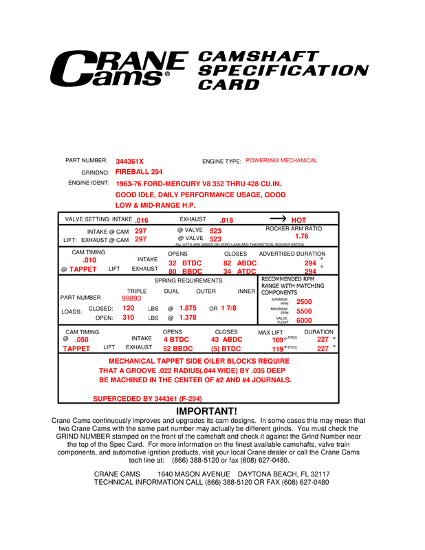

Here is the page out of my '81 Crane catalog. it's a pretty mild cam, by today's standards.
Maybe you could have a custom one ground but, it only has a lobe lift of .297. I looked around a little and couldn't find a SL cam, with that lift/duration but, you could come somewhat close with a hyd cam. Especially if you use the 1.73 rockers.
CC lobes
----------Adv-.050-.200-lobe
In 5520 279 227 137 .306
Ex 5129 276 227 134 .308
Howards lobe In & Ex
----------------.006-.020-.050-.200-lobe
1hf227300LR 280 254 227 139 0.300
« Last Edit: November 26, 2020, 03:09:21 PM by frnkeore »

The numbers for that Fireball cam looks a lot like the Oregon Cam #624 solid flat tappet cam that I have in my 59s 428CJ. .528" lift, 228 @ .050" duration. I chose that cam due to the great manners a similar Cam Dynamics "Stage 1" solid flat tappet cam that I ran in my old 70 428CJ 4 speed Mach 1. Good vacuum, good idle, ran mid 12s at 111 MPH shifting at 5600 RPM.

Crane can grind me one, but they are out of FE cam blanks and don't know when they will have any... I am screwing together a 352/360 and want to duplicate the original cam specs.. Werby thinks the Fireball is almost an exact duplicate.. I am going to talk to Oregon about theirs.. Was hoping someone had the Crane on the shelf looking for a home.. Even a used one
