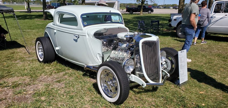

And yes, Flatheads used to have overheating issues, and yes, much of it is centered around the exhaust ports, particularly from the siamesed center ports, but modern water pumps and better radiators have pretty much eliminated those issues with modern builds.
I recently spoke with the owner of this car about this subject. He can drive this car anywhere, in any temps, and it never overheats or gets hot. These cars have very limited space for extra cooling capacity when it comes to radiators, but good tuning, modern pumps and a modern radiator have made it a non-issue. That may not be the case on a max boosted build, but I'm not sure extended street use is the goal here.
