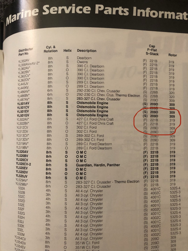

I have two older Mallory catalogs,  I checked the Jan 1979 Mallory catalog, and I couldn’t find anything  with either that distributor number or the flat cap & rotor, but in the Oct 1988 catalog I found a diagram and part numbers on the marine distributors which shows the flat cap. I didn’t see any info in that catalog on your distributor part number though. The diagram shows a part number 319 rotor. It also shows that 319 rotor with a 427 Chris Craft marine distributor with flat cap. I did a little internet searching, and it looks like that 319 rotor has been discontinued, but maybe not long ago. It shows it discontinued on the Holley website, but still has the picture up. There are some NOS Mallory #319 rotors on eBay, with pictures, so maybe that will help to see if that’s the right one. And yes, Summit shows that #221B flat cap as still available new. Here are the catalog pages I’m referring to.

Thanks a TON Kevin.  That is the kind of information I was looking for.
The rotor they show is the typical "taller" style that fits a std cap.  It does physically fit my distributor shaft, but is too tall for a crab cap.  I played around last night with a std cap and std rotor and it "works" but the cap is sloppy due to the difference in body diameter where it fits the distributor.  That is why I will have to do some modifying if all else fails.  I have the teknulogy!!!  ;)

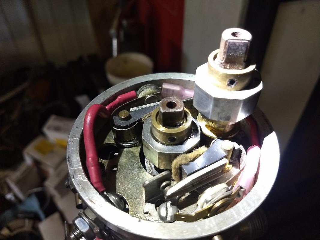

I just checked the pickup and wagon, both have newer style YL rotor with larger shaft and much better fitment.  These early YL have just 1/4" of engagement on the .375 shaft and become sloppy very easily.  The distributor I just got had a spring clip installed to give more "tightness", though it was still sloppy on rotation.  I found another upper piece and thought it was tighter (with no spring clip) but it had rotation also.  No good for setting timing when rotor moves 5-10*.
I removed the upper rod and realize it is an easy fix.  Just need a piece of .375 rod and mill a new flat that is more inline with what the rotor is.  The old shaft is like .300 across the flat.  The rotors are .330 which gives it slop.  Pretty ease upgrade for when that new rotor shows up.  I'll hit Summit for a new cap and points.  It should all come together now.    I have a few pictures and will post them later.

This is the top pin that the rotor registers on.  The flat is cut too deep, thus making the rotors sloppy enough that they can rotate around.
This is the two mounting shafts.  The one shows the spring plate that does near nothing to keep the rotor snug.
The one in the distributor is more snug on the shaft because it is 1-2 thousand larger, but the flat is still too deep.
Being they are only .375 mild steel it should be an easy fix to remake it.
