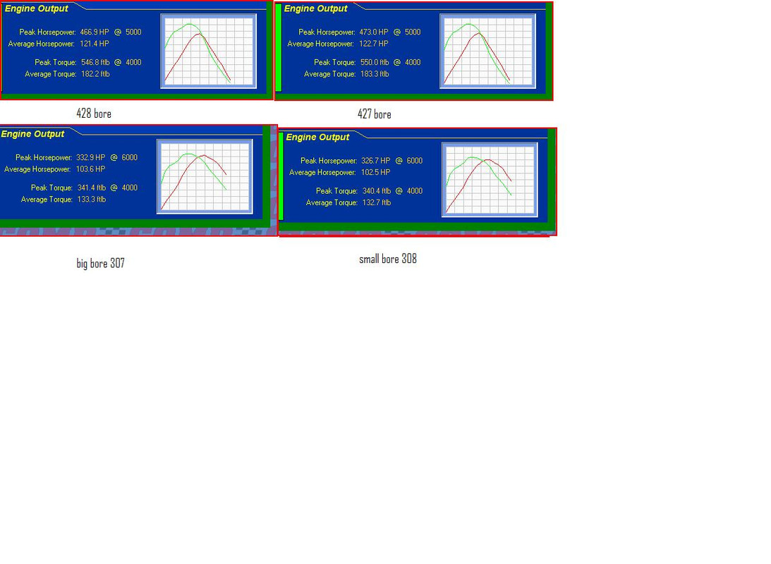

« Reply #28 on: June 17, 2020, 08:57:41 PM »
So let me caveat this that all I did was plug some numbers into the Camquest software, which is free, easy to plug numbers in but I have no idea the assumptions associated with it, or how capable the "guesser" is.  However, it is an easy one to get to on my desktop and had some saved files to lean on
Plugging no changes except for the bore and stroke Frank had, I got the that chart.  Is it accurate?  Who knows, but it does show what I suspect real world would show, ever so slight advantage to a bigger bore for breathing, but not really enough to make a wild difference
Keep in mind, I cannot validate the accuracy, I don't even use this one or compare it to real dynos, but it was an easy one to change data and copy/paste.
FE on top, SBF on bottom
« Last Edit: June 17, 2020, 09:00:17 PM by My427stang »

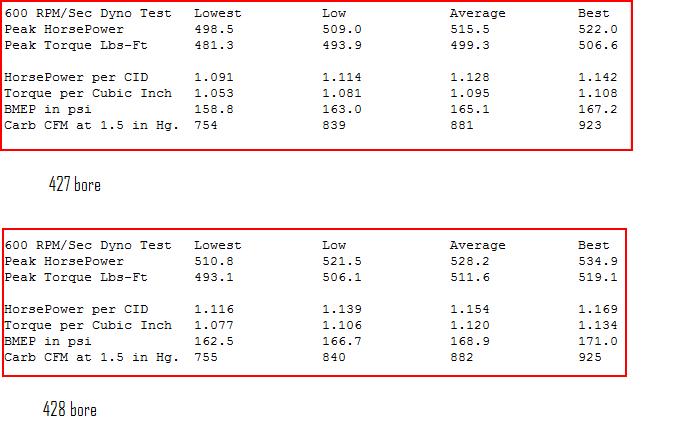

« Reply #29 on: June 17, 2020, 09:09:16 PM »
Just for laughs I did the FEs on Pipemax, came out almost the opposite.  Pipemax is a pretty good program, but who knows now
