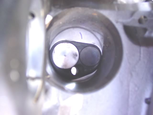

Frank, I use an old version of EA Pro, which I can adjust a lot but nothing specifically for shrouding.  I have been able to back into some accuracy after real dyno runs, and in that case, I would only change bore and stroke from a known accurate run.  Although I could likely reduce some flow at lift numbers, or increase them for a 427 bore, I am not sure how I would estimate that accurately
Take a look at this picture though.  This is a 4.05 bore, 2.15 Ferrea valve.  I don't see as much of an issue with intake shrouding.  We would add .110 of bore (.055 radius) for a .030 over 428 then consider the mass of the air charge and it's direction toward the spark plug hole. It doesn't seem like we need much more room or valve  that 2.15 combo can easily be a 300+ cfm head
Of course shifting to a medium riser spacing and shifting the valve over changes things,and needless to say, the 1.67 exhaust valve is pretty tight in that 4.05 bore, but the intake seems to be pretty roomy.
