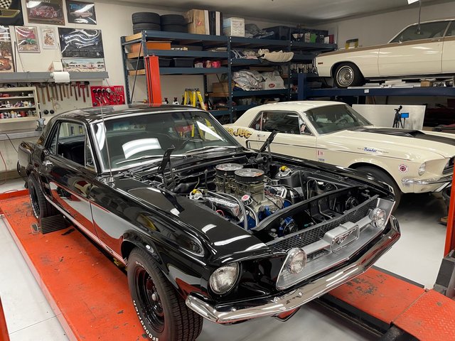

Looks good Mike!  You should have flipped the headers forward and told your friends it's going in a V-drive boat  ;D

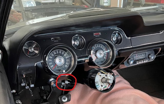

To be totally honest.....it's a pain in the butt to install. But anything under a Mustang dash is a pain. It becomes very difficult to find a location for the motor of the unit to sit when it's a 4 speed car. All the clutch stuff gets in the way. We found one position where the motor was able to be tucked up underneath the dash and not interfere with the clutch pedal or linkage, this spot required that we cut the air vent. Theres a 2" or 3" wide cut in the plastic that allows the motor to rotate up during installation. If it's a race car and you aren't so concerned about getting the unit out of sight, the installation would be a lot easier to deal with. On an automatic car I can also see the install going much more smoothly.
As far as operation, I'm really happy with it. One of the nice benefits is you don't have to have the engine running for the assist to work, just click the key on and you have assist.
I took this picture right after we got the steering column put back in for the final time. I circled the unit, with the location we found that's how much of it you can see. We were happy with that, doesn't stand out too much.

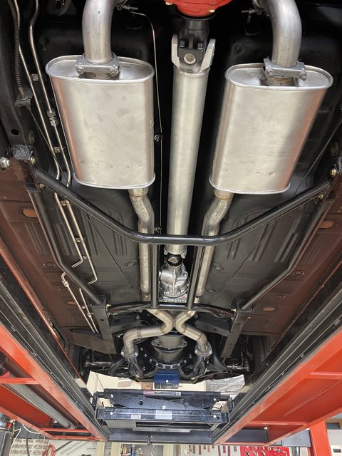

Exhaust is done. Car is ready for the road again. From the little bit that we have driven the car around the block so far, we're noticing that the McLeod twin disc clutch is pretty grabby. It's either off, or on. Hoping that it breaks itself in and gets smoother.
