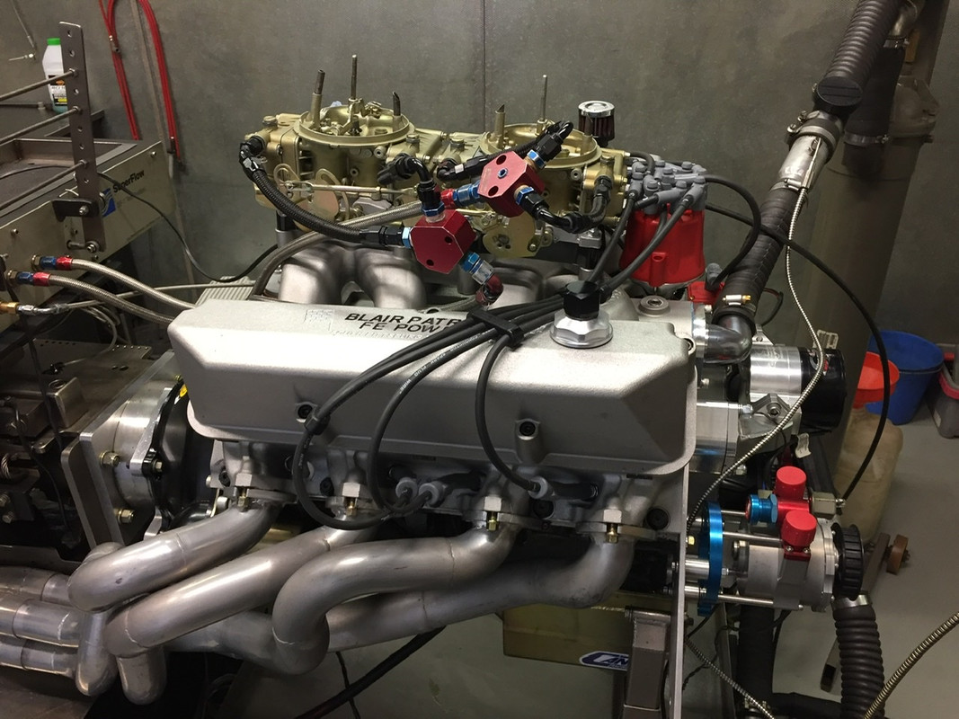

This engine is destined for my 64 Fairlane drag car. Apart from the compression ratio, it could easily be run as a serious street/strip type engine. I sourced the heads, intake manifold, rockers, cam and pistons from Blair Patrick, and my brief to him was I wanted a strong, reliable, relatively low maintenance engine to run in my drag car. As I only plan to run the car a couple of  times a year, I didn't want a highly strung race engine, but something that was easily identifiable by looks and performance as an FE. I think he met the brief perfectly, and I'm very happy with the result. I think there is still a bit more hp to be had from the engine with a pair of more tuneable carbs, but the 660's fit nicely inline and will look correct under the air bonnet in the car.

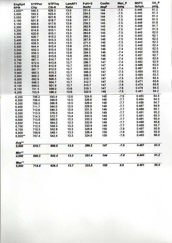

Below is the chart from the dyno. The dyno operator started the run at 5000rpm, as that is the stall speed of the converter I will be running. He did do a few lower rpm pulls before hand, and the torque was a bit higher at lower rpm's, but I don't have any evidence of that, so those are the numbers I'm working with.

VP MS109. Leaded racing fuel is now outlawed down here.

Very nice engine!  I'm going to guess that peak torque was around 4300 to 4400, depending on headers and collectors used.  That should move the Fairlane right along.  Congrats to you!

The power runs were done with the vacuum pump hooked up, it was pulling about 8” of vacuum.

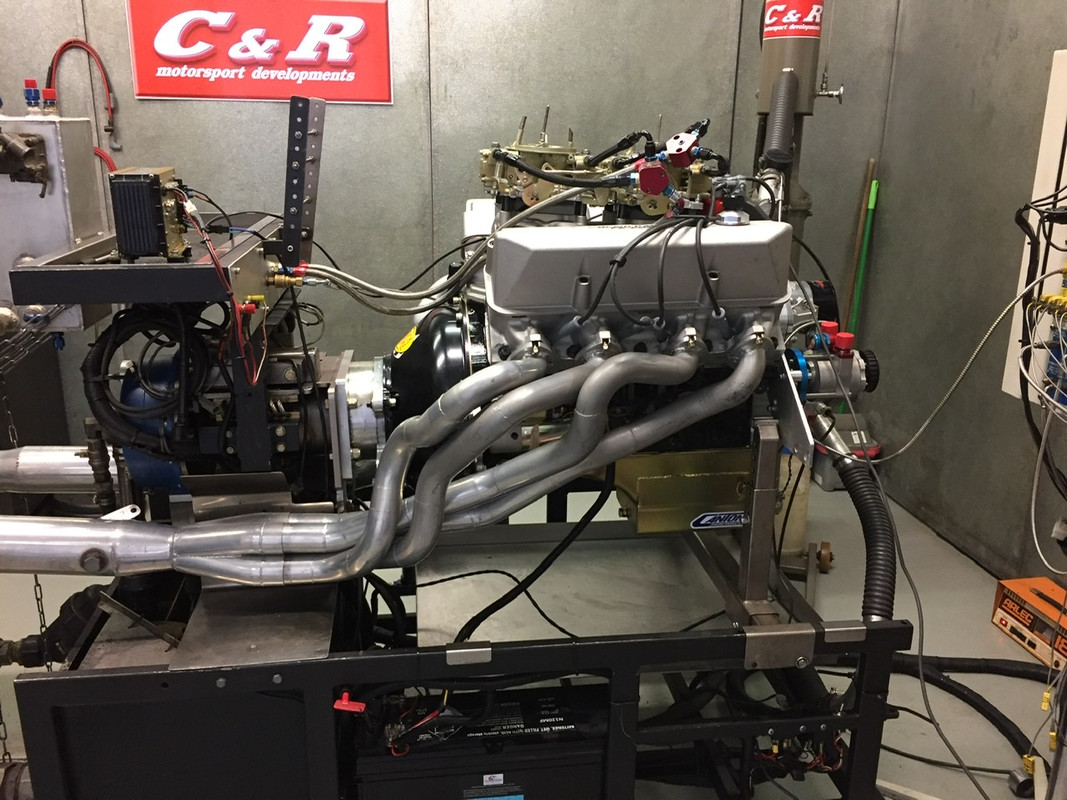

Nice! Say, who did the headers? Tube & colletor size and overall length? Looks like they would fit under any early Fairlane with an OEM front end, unless the car has a tube chassis front clip.
ToddK
  • Posts: 442
Re: 505 FE BP Pro-Ports Tunnel Wedge Street/strip
« Reply #11 on: May 21, 2020, 08:30:02 AM »
The headers have 2” primaries, not sure on length, but the local guy who built them tried to make them as equal in length as he could. The collectors are 4” diameter.

Nice valve covers  ;D  That engine is a dead ringer in performance for the 511" FE that I ran at Drag Week in 2005.  Very similar build, except mine had ported Edelbrocks and a worked over Victor with a Dominator 1150 carb.  Peak torque on mine was 634, and peak HP 706.  At Drag Week I drove that engine from Minneapolis to Kansas City, then from KC to St. Louis, St. Louis to Bowling Green, Bowling Green to Columbus, and Columbus to Martin Michigan, then back home to Minneapolis.  2500 miles in one week.  I'll bet your engine will be just as street friendly, and pull down some great track numbers.  Congrats!
