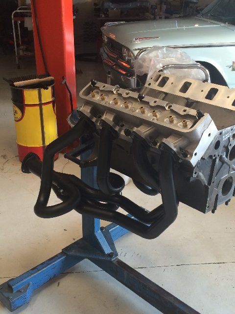

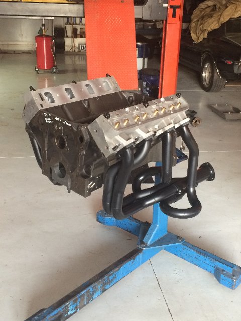

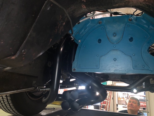

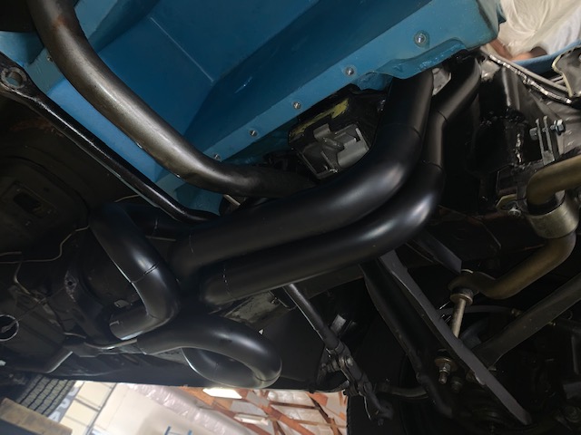

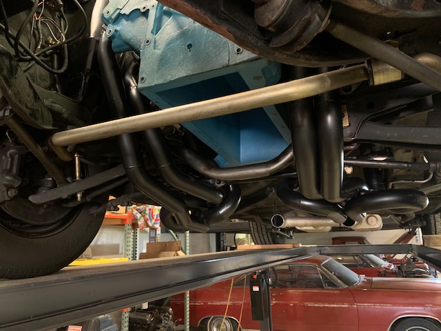

Do your REF headers have 1-7/8" primaries or 2" primaries? We mocked up the REF headers on the Mustang this weekend, our Mustang also has shock tower reinforcement plates, but they fit actually super well. Ours are the 1-7/8" primaries.
We wrote ourselves up a whole procedure of the order we put everything in. One thing we had to do is drill a hole in the shock tower for the #5 top flange bolt, it was impossible to get that bolt in without doing something like that. At #3 the shock tower also required some grinding on the reinforcement plate, and we slotted the top flange to get the bolt in better.
Tube's went in one tune at a time. Drivers side, #7,#6,#5, then #8. Passenger was #3, #2, #1, then #4.
Picture's don't show up too well because it's black headers on black engine compartment.

ALSO, the REF's will absolutely not work with a power steering idler arm. We are ordering a new manual steering idler arm. The Mustang has a flaming river steering box in it and that all cleared too.

Man, there is some ugly lookin' cuss in that first pic! LOL
Yes, they seem to fit well and alhough most won't see it, those bends south of the motor mounts look like old Trans-Am and sports car headers. Nice!

Just judging by the pictures, they look like they will be real close to the filter adapter. Have you tried fitting it on the block? Some of the aftermarket billet jobs are pretty thick, so might be an issue with them as well. And they obviously would not work with the factory cooler design like I have on my car, but the old race Hookers won't work with that either, as well as the Mad Dog race headers and others that have the #5 tube that goes straight down.

My REF are step headers that start as 1-7/8 and step up to 2-1/8. The flanges are 1/2 thick. The Idler arm was not a problem, but the Pitman arm was until I changed it to an original Ford style and not a reproduction style. There is a difference. I also changed to the manual steering link with my Borgeson box.
Doug, we will be running a remote filter. I caught onto this Saturday and did some questioning. For non drag use they suggest running a remote style unit. For drag race only, a standard housing can be used and you don't run the car for long enough that it becomes a problem.
