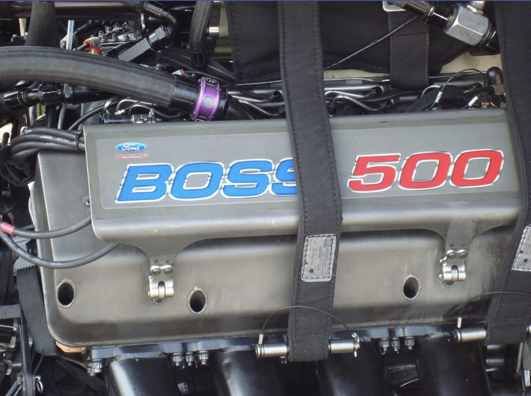

In 2007 at the SEMA show in Vegas ( if my oldsheimers hasn't kicked in ) Ford had a display nitro engine Force was involved with which was planned for Funny Car. It was based on the 385 platform. I remember it well because the injector hat had 2 blue butterflies with BOSS engraved into them. Was PRETTY !  NHRA shot it down and I think is the reason Ford quit them.
