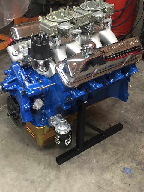

The ones on my 390 dyno mule were from Scott Drake and were very nice.  They were baffled.
The area involving the baffle is always the tight spot but you should be able to make them work with almost any rocker.  Worst case scenario, you double up the gasket.

  • Posts: 5399
Re: Reproduction Power By Ford Valve Covers
« Reply #6 on: December 08, 2019, 03:41:40 PM »
  • Posts: 1042
« Reply #7 on: December 08, 2019, 04:12:12 PM »
Nice!
