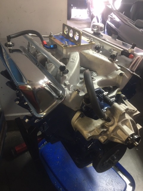

As in the other post, dyno day is 15 Nov.  This one may be more tricky, this one is going in my 1971 4x4 truck, so a bit more mild
- 461 inch FE, Racetech pistons, 24 cc D-cup, 1.5/1.5/3.0 Mahle rings, 9.80:1 compression, .010 above deck and .041 quench distance, as with the others all good machining, torque plate etc
- SCAT 6.70 rods, SCAT crank, internally balanced
- Ford windage tray
- D2 heads, 2.09/1.67 CJ valves, undercut stems, good valve job, ported by Les Schmader, medium riser port entry dimensions, flow 277-280 intake side at valve lift, 195 exhaust
- Cam is hydraulic flat tappet, 280/286 adv, 230/236 @ .050 .585 lift, 112 LSA on 106, Lykins rockers
- M57HV standard oil pump
- Victor EFI intake, port matched and some blending on roof, nothing aggressive, but nicely matched to med riser port
- Not running EFI, although injectors will be in there, will be running a standard distributor AND 850 Holley for the dyno
This will likely be lower power, and lower peak RPM, but should be pretty strong just the same and is built for a 4x4.  Dyno will tell on the evening of 15 Nov.  Guess away!  We may even try something goofy on this one like a big Dominator to match the 1000 cfm airflow of the future EFI, we will see how the day goes.

Uniquely ahead of where I should be LOL.  Loading up Monday, goof off Tuesday and hit the dyno Wednesday!
The secret sauce will be a special distributor and wires off Brent's 352...didn't feel like pulling a distributor out of a running vehicle and the engine will get a locaked distributor with ECM controlled curve, so no use on the dyno.  Brent offered to let me use his MSD from Project Junkyjunk
Who knows what random carb will end up there, I want to get a big one on there at some point for fun, but it likely only needs a 750
