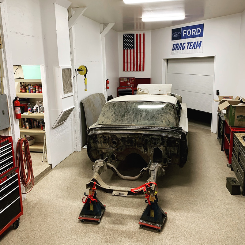

Within the past few weeks I was able to get a single stall conditioned room in the barn set up to work on some things this winter. I'm admittedly pretty fussy about cold weather.
We have been collecting parts for the Starliner for about 2 years now it seems like. Its a hipo 352 car, black with black interior. With help from people on here I was able to locate the correct engine that actually date codes with the car very well. I will be taking all the windows out and stripping out the rest of the remaining interior. We'll take it to the blaster, and then over to a metal working shop. We visited the guys shop a couple weeks ago, he is incredibly talented, we'll only be using about a tenth of his ability with what this car needs (trunk floor and some body patches). https://tinelement.com/ The low drag jaguar on his site he built from scratch.

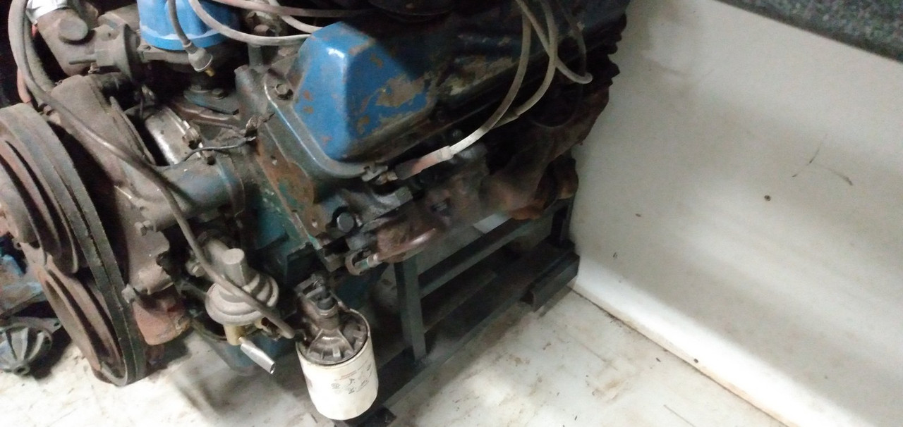

Blair, here's the engine. A guy in Indiana had it sitting in his barn. It's got about 75% the right stuff on it. He had an air cleaner lid, but it was for a '61, not '60. Looking back, I should have got the air cleaner lid anyhow so we at least had something. It's supposed to have been rebuilt, run on a test stand, and then stored, but it'll need taken apart and inspected.

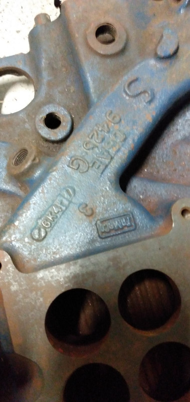

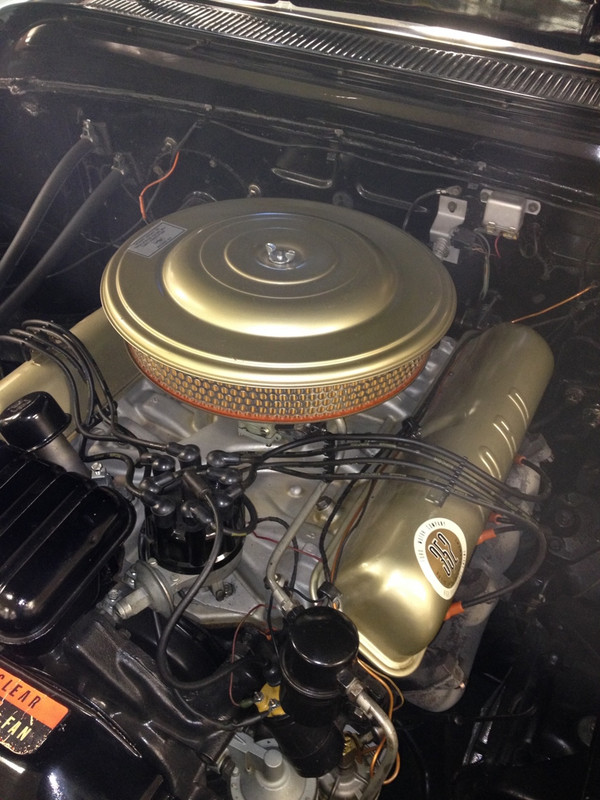

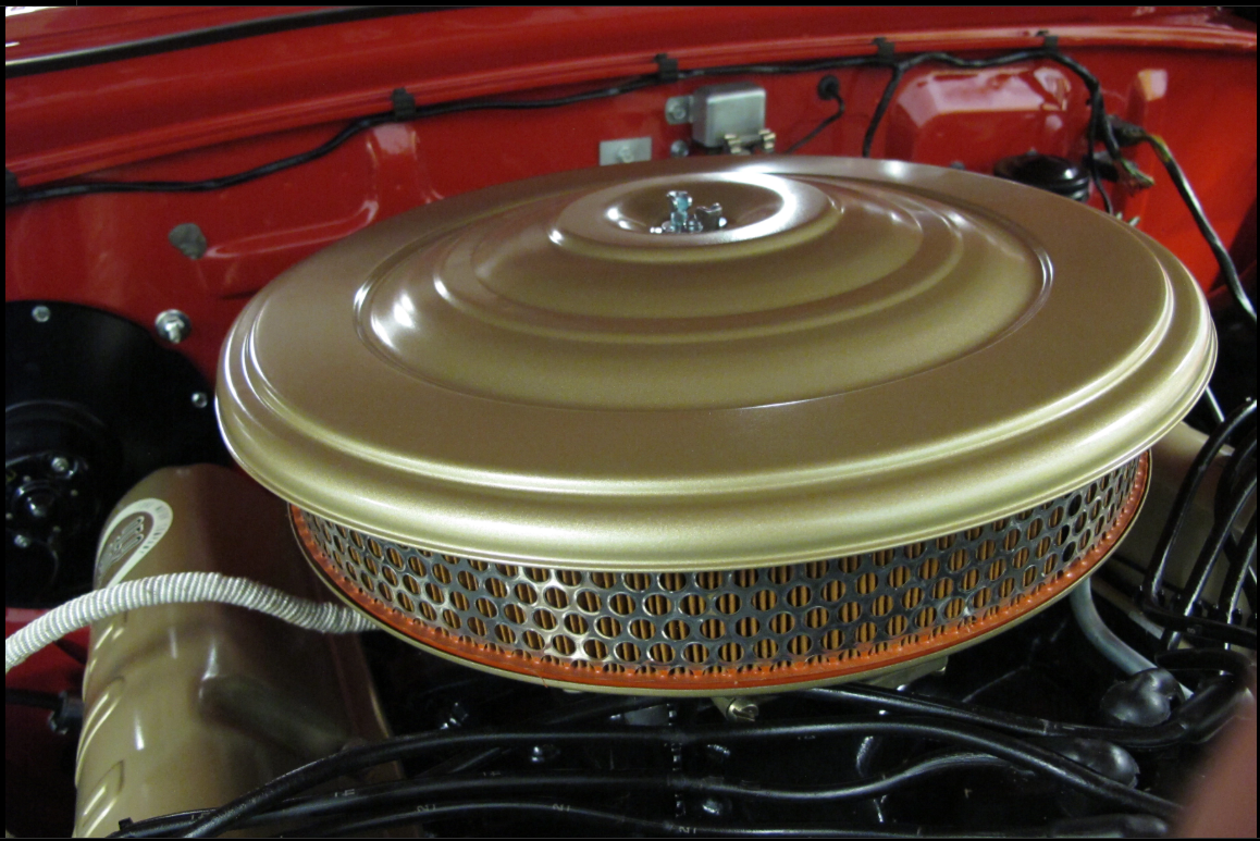

Richard, I put a couple deals below so you can see the difference. This seems to be something that gets overlooked quite a bit. The second picture is from this car https://www.hotrod.com/articles/super-rare-superstar-1960-ford-starliner-360hp-high-performance-v-8/  One of the most nicely restored 60's that I've seen, but it has a '61 lid on it. Might be because of availability, in my searching I've drummed up 3-5 times as many '61 lids as 60's.
This is the correct '60 lid:
This is a '61 lid:

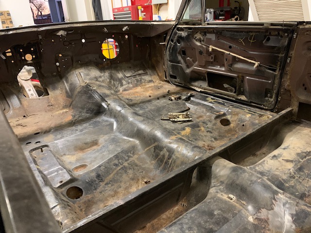

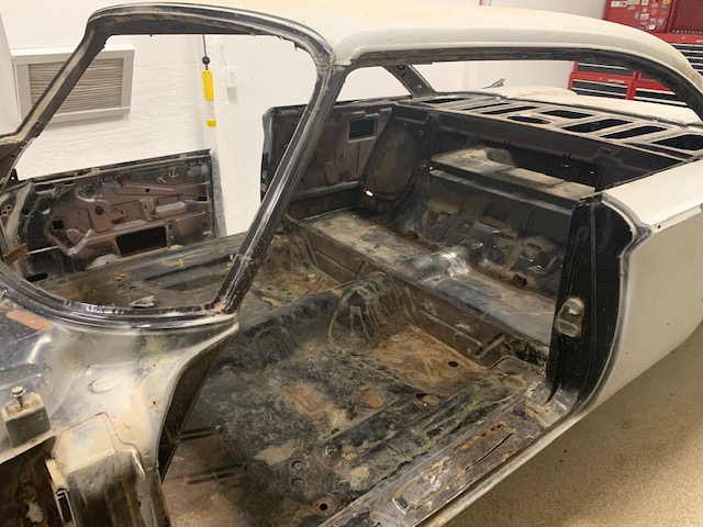

The car is now a trunk lid removal away from being 100% stripped. I spent a lot of time chipping away at all the seam sealer, not real sure if that was necessary or not, but I wasn't confident that the blaster could get it up. No huge surprises yet. The drivers foot area is the worst portion of the car, it is rusted through, but we could see that already. This week/weekend I'll build a metal frame for under the car and get it off the sketchy skates. Should be blasted soon, then we'll really know the condition.
Wondering if anybody has used this AMD floor pan? Judging from their pictures it looks pretty darn accurate.
