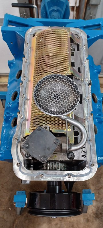

Tunnelwedge
  • Posts: 275
Re: Putting A Little Pep In My 390's Step
« Reply #96 on: September 13, 2023, 05:45:45 AM »
Same windage tray and scraper as before.
Interesting. I use similar screen and I had to cut a piece out to get the stick to fit.

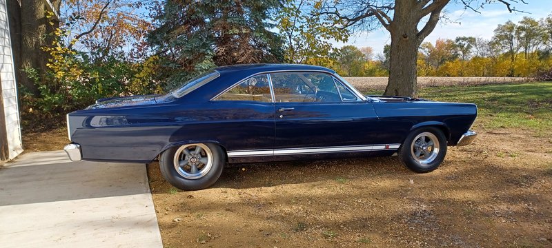

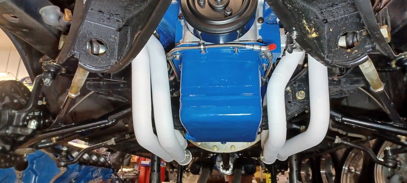

Picking up where I left off with a minor update. Engine has been in the car for about a month now. Finished up the loose ends. Weather has not been cooperating lately, so I figured last weekend I would clean off the 3yrs of accumulated dust and picked up a buffer and gave it a little polish. Paint looks okay for 39 yr old lacquer but is showing some age in places. Here's the engine installed:

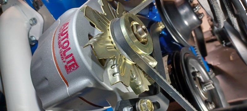

I found an ink stamp for the alternator, so I made the powermaster unit look a little more original.
Weather has been awful lately, but today it cleared off and made it to a whopping 47degrees. I managed a couple shake down runs today to test the new ring and pinion, new clutch, new front and rear tires, and new engine to seat the rings under load. I turned the electric fan controller up high to let the engine get some more heat in the cool weather, but the hottest it would get is 170°. Carbs need some fine tuning and a couple very minor things to address, but overall a success. Finally outside again:
Will have to wait till spring to get to the track. Tomorrow is the last day our track is open. Oh well, there's other stuff to do until then...
