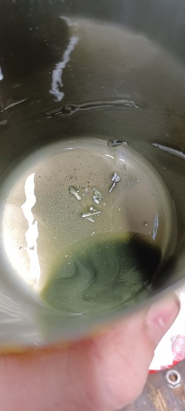

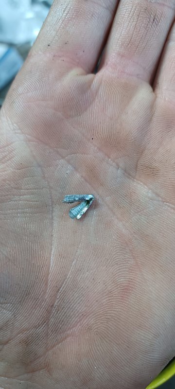

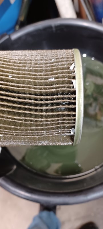

Then I check the radiator and it's down some. Great. Figure I might as well cut the filter. As soon as I pull the filter I'm greeted with this
Cut it open to find plenty more where that came from.

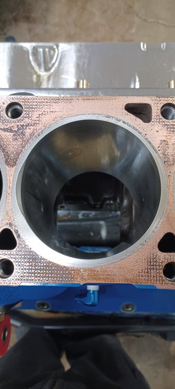

On the left side of the screen, you can kind of make out the valve reliefs on the piston. And a bunch of water on the right! Half the piston is submerged. I figured it better come apart so things don't get rusted inside. Pulled the engine out yesterday and got started on the autopsy. Once I got the head off, I found the obvious cause:

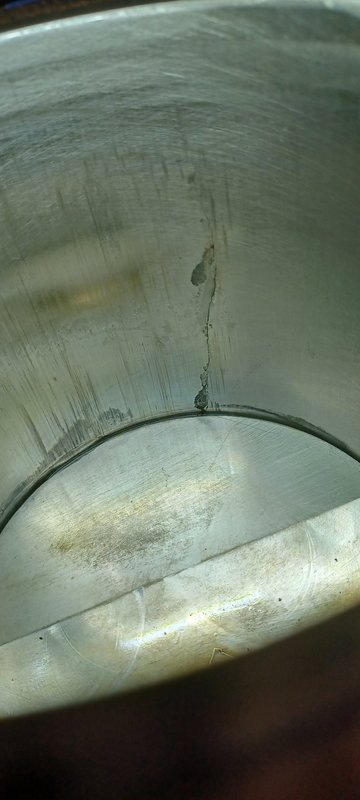

The knock:
The cylinder has a pretty long crack.

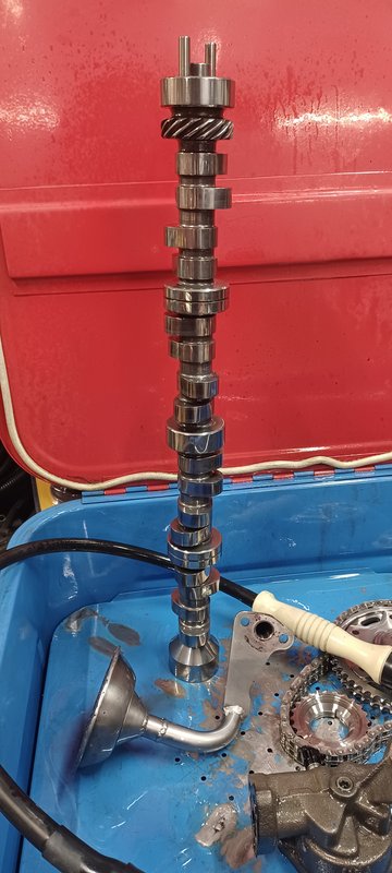

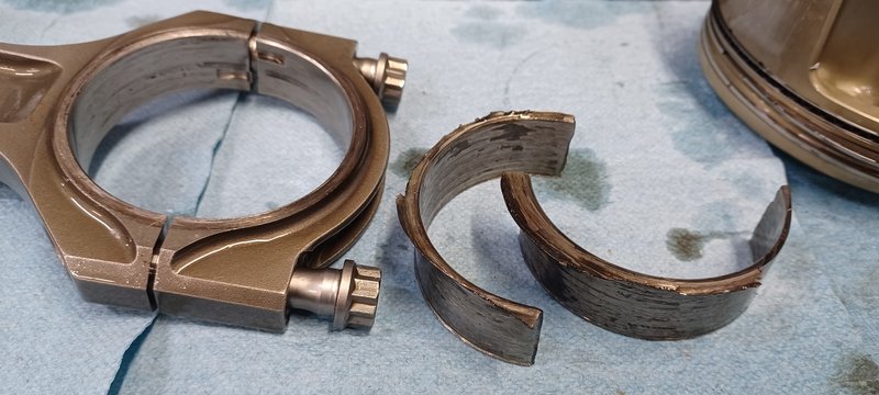

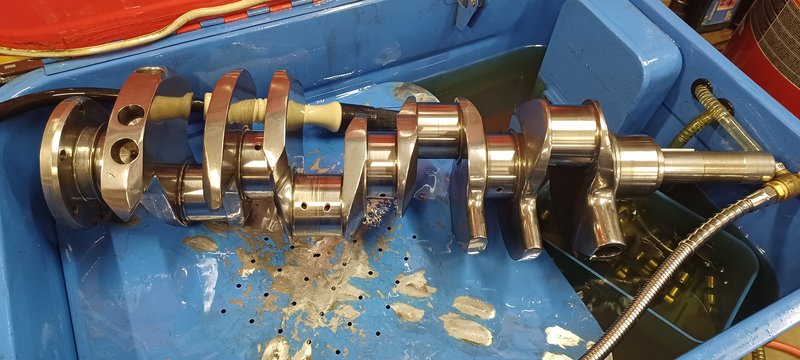

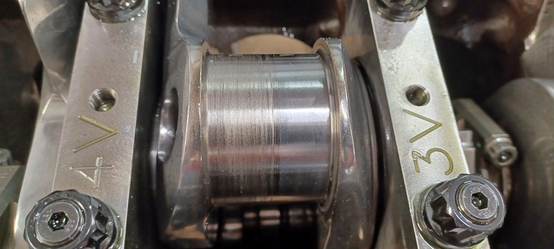

The big end on #7 rod is pretty ugly. Don't think it can be re-sized, so prolly need a new one. Luckily the damage was very isolated. Every other journal looks like it never ran, like I just assembled it. I think the coating on the bearings and a good oil additive helped me out. Looks like the crank can be turned on just the rods. Cam still looks like chrome from polishing. Can barely see where the lifters were riding.
Crank still nice and shiny.
Haven't gotten the oil pump apart yet, but hoping the aluminum bearings did minimal damage. I guess it could have been a lot worse. It was a one hit wonder. Butt dyno said it was making every bit of the 335hp factory rating when it let go.

Look VERY carefully at the head gasket.  Take a mic to the areas around that cylinder to check for clamp load and look for deformation around the bore compared to the other openings.  Check piston to see if it clamped the second ring tight.  I have had a head gasket do some considerable damage in the past.  If it leaks coolant it can cause the cylinder wall to split since water does not compress.  Starts a daisy chain of failures.

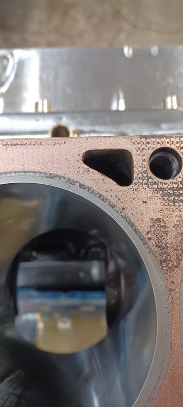

I did take a good look-see at the head gasket. No visible issue at the fire ring or water ports. Head was welded pretty good with the copper coat. I haven't mic'd the ring yet, but don't suspect a problem there. I will look. Rings were still nice and free. The piston barely dinged the chamber when the bearing gained clearance. Very small mark that will rub right off. No sign of detonation or pre-ignition on the plug or piston. My gut right now is telling me that cylinder just didn't want to play any more.

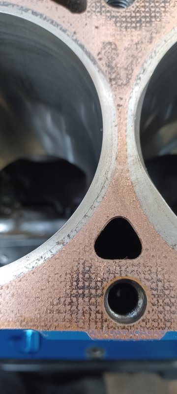

I was able to inspect the deck and head gasket a little more tonight. No sign of compression leaking anywhere on the deck or head. Fire ring on the gasket was checked with a micrometer in at least a dozen or more locations. Variance was only .001" total. Even right across from the water ports. Here's the deck:

Well - that don't look too bad.  Can probably rule out the gasket.
Wish I had better ideas but starting to look like a sh!t happens" sort of deal...
