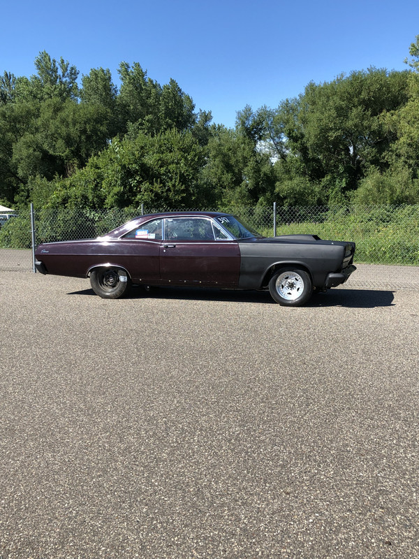

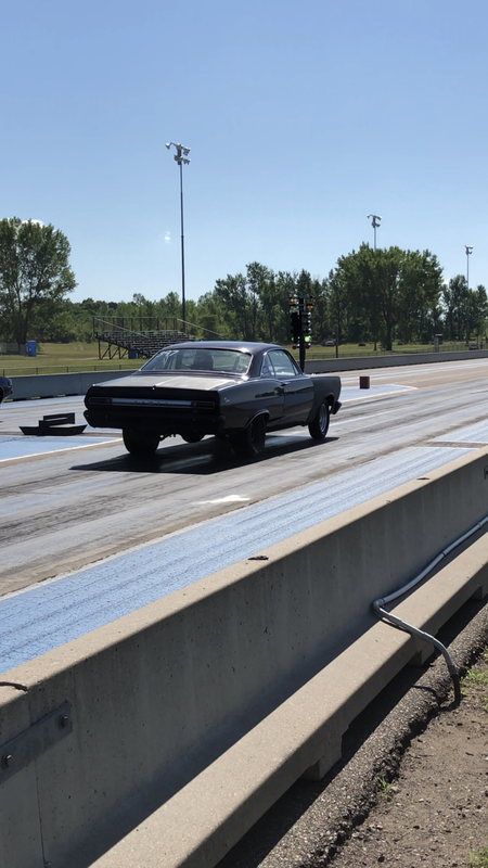

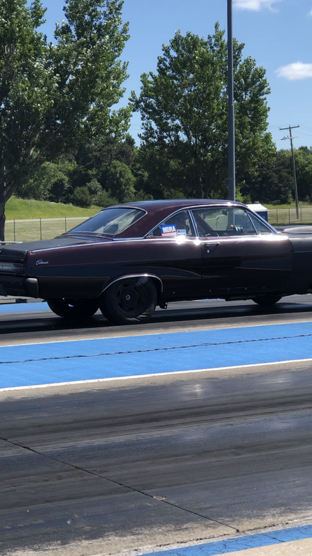

« Reply #14 on: July 27, 2019, 06:25:40 PM »
