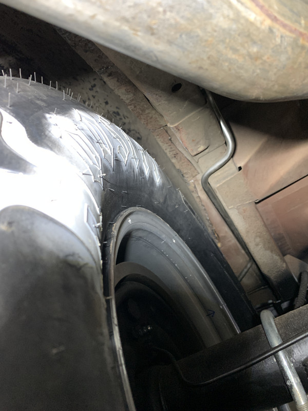

Jim, a 10.5 x 29 will fit with some mods and the relocator kit. The snubber has to go and the inner wheel well lip must be sectioned and folded back. The rim pictured is 15 x 10 with a 6.5” BS. No mini tubbing. This is on a ‘67 Fairlane.
https://i.postimg.cc/ryvGpzW0/9-DA19950-320-A-49-B4-8-C4-A-080-A4599-CD71.jpg
« Last Edit: March 29, 2022, 07:51:31 AM by 6667fan »
