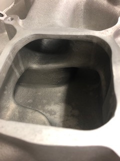

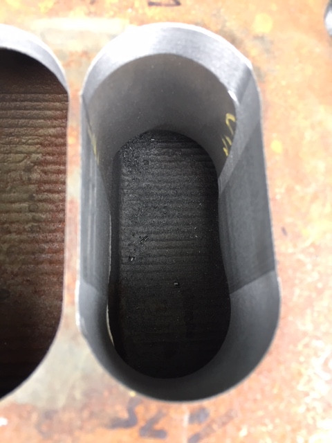

Sounds like it's late to need, but we modified a CJ manifold by making all 4 barrels the same size, then cutting into 2 ovals, like a modern manifold.  Once doing that, you will see the lower plane has a sharp corner where it turns toward the cylinder bank, blending that corner, or even cutting a 45 to help it turn is a big benefit.  We ported it heavily too, and it held 520+ HP to 6000 rpm on a 461 in a 237@.050 single pattern cam 114 LSA.  In hindsight, I wish I would have cut the plenum divider down too, but regardless, it turned out real well.  Something to consider if you decide to chase more power and are willing to grind on some old iron

Ross, I think this is kind of what you're hinting at, cutting the center divider out and everything. This manifold was storied to have been prepped by HM, but nothing other than a story to back that up.

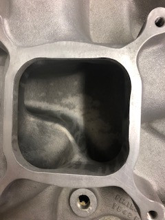

I typically don't cut that far, I do a notch like you see in modern intake, my thought is that it equalizes pulses more than it really allows cross port airflow, but who knows.  Generally seems to help.
Here you can see how we modified the top, and you can see how close the lower bank is to the plenum floor. This is pre-porting as you can see that 90 degree edge.  As far as the divider, if doing it again, I would have likely put a maybe .750 deep by 2 inch long divider cut and blunted all edges

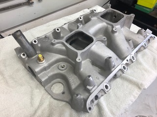

It looks like you did a very nice job on the intake. Why did you stay with the CJ manifold and not update it with an aluminum single plane? We just order a track heat for our 445.
I think I missed this one, this was for a hidden stroker in a concours-driven 68.5 CJ 4 speed 4.30 car.  Owner wanted stock.  I learned a few things on that one, but made good power
Here's the write up
http://fepower.net/simplemachinesforum/index.php?topic=7690.0
