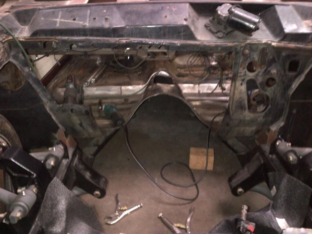

More cutting

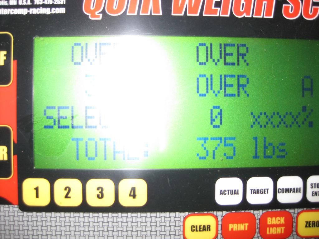

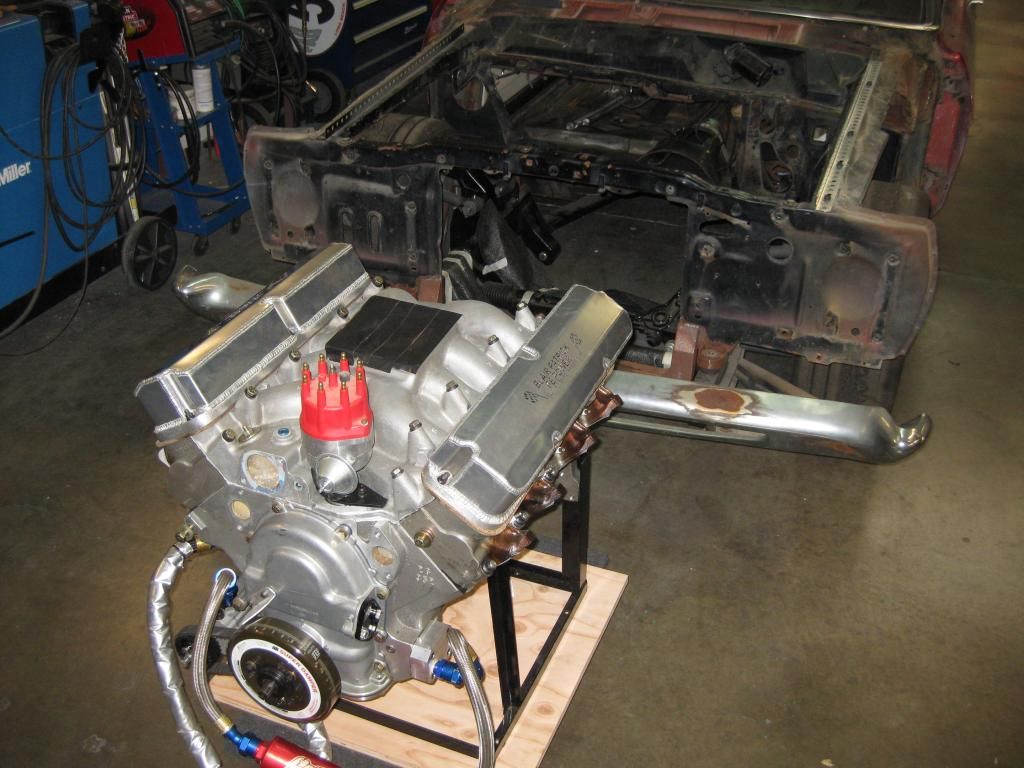

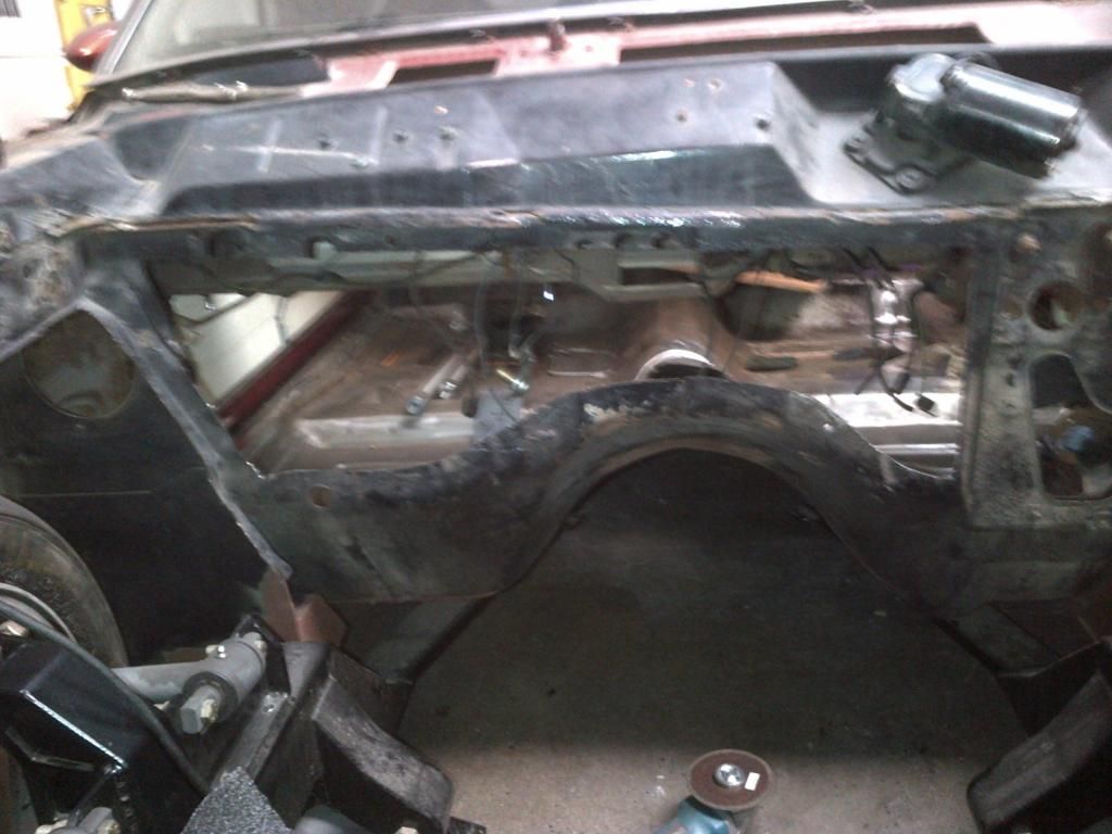

I finished cutting out my firewall and tunnel for the motor set back project.  Then brought my motor down to the shop and for the hell of it weighed it on one of my intercomp scales.

Who says FEs are heavy LOL!  Nothing like an aluminum engine...
Re: Blair Patrick thanks for my Tunnelport for my 69 Torino Cobra project
« Reply #80 on: October 27, 2013, 03:54:49 AM »
Dang, that is light. Just the weight difference going from an iron block to an aluminum would make a road-racer have to start from square one in tuning the suspension I would think. Good thing you're already there  :D
And those exhaust ports certainly have been "heat treated" by Blair...lol
« Reply #81 on: October 27, 2013, 03:57:15 AM »
Just 20 LBS more than a 4 cyl Volvo
Jay
Remember when you weighed my single 4 TP intake you said it was the lightest FE intake you had seen to date.  If I ran AL heads I could shave another 30lbs? ;)
Doug
The heads are cast iron and clear coated after a fresh peeen and bake to look like AL.  But when you do three days on the dyno the clear coat takes a beating.  ;D
As far as square one on teh suspension you got that right.

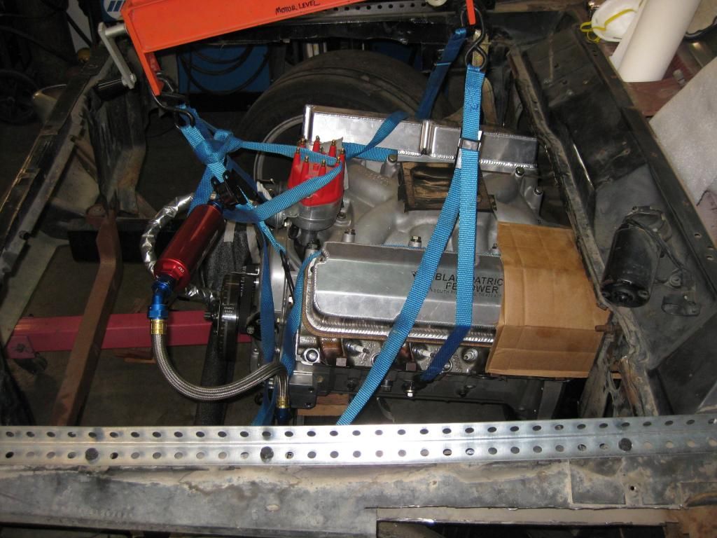

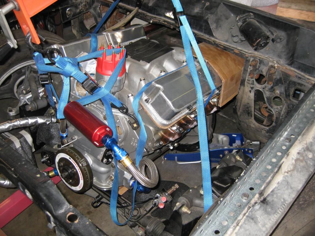

Did a quick first test fit tonight

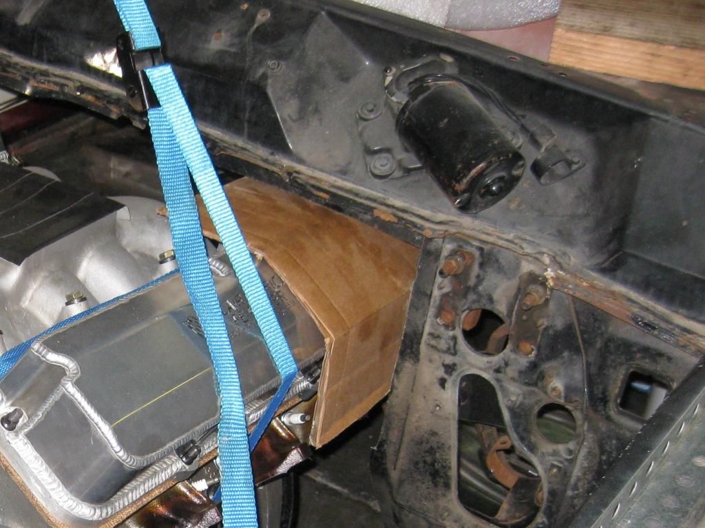

It really isn't good for engines to sit. You should loan me that thing until you're ready for it. I'll keep it oiled up for ya ;)
I think I'd be notching that dang cowl too. First time I went to remove a valve cover, I'd be cussing that thing.....after locating the dropped bolts....
Thanks for offering to keep the engine warm but I think it will be ok.   ;D
I am sneaking up on the cutting.  I do want some more clearance to be able to adjust the valse without pulling the motor.

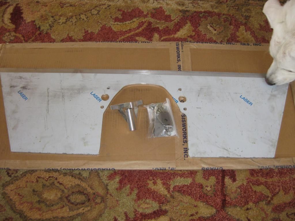

My Alston Chassisworks front plate arrived and passed inspection.

As I kept trimming the firewall further and further to give myself clearance to set the motor down and back it became apparent that the stock hanging pedals weren't going to cut it.
Here was the first test fit with a minimal cut.  In this picture the motor was still .25" off center and you can see I have no clearance between the VC and remaining firewall.  You can also see how close the 4 bolts that hold the stock pedal hanger are to the VC.  I ended cutting the firewall to the other side of the mounting holes so no more stock pedal hanger.:headscratch:

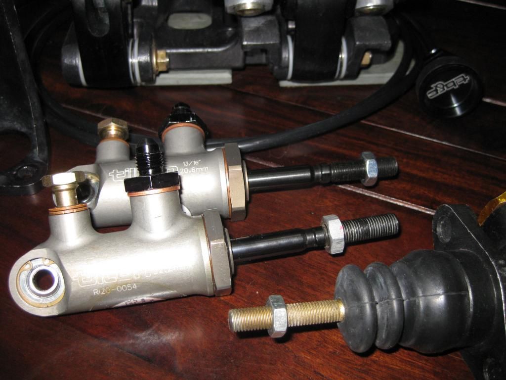

Although this is a 600 series Tilton Pedal set up it has the 900 series bracket to run the Series 77 master cylinders.  The mounting of these is supposed to eliminate binding in pedal travel and the migrating of the bias due to some of the binding.

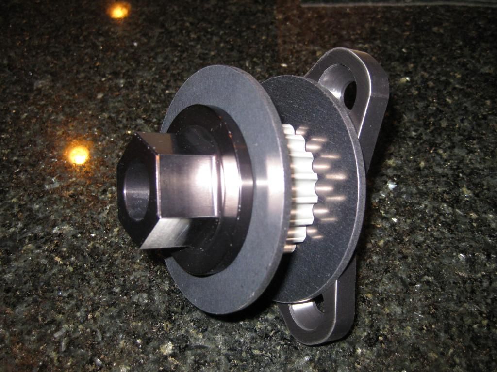

 The front plate will also give me a nice plane to use for the PS pump and alt mounting brackets that don't yet exist.  Since I have a Peterson stackable mandrel drive I can use whatever existing PS or Alt brackets I like the look of and tailor the belt alignment via the position of the pulleys on the Peterson Mandrel.  Those parts arrived long time ago so here is a reminder what they look like. This is better than digging through the wrecking yard this thread sorta is.:D
The Midplate will be a custom piece that Brett will fab.  The front plate I got from Chris Alston Chassisworks.  It has plenty of extra material I will trim off once all the final mounting positions of the motor and accessories are determined.  As you can see in the photo my chief parts guy checked it all out and told me it was good to go.
