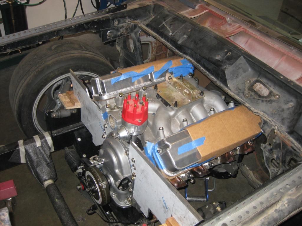

I think I'm going to get some .375 6061 AL once I work out my final motor plate design and build it using that.  The .250 just doesn't make me feel warm and fuzzy.

I ended up using 10mm Al plate for the front motor plate, just 0.5mm thicker than .375" plate. I had bought a plate from Comp Engineering, but I didn't like the look of it. The front plate needs to be strong. Are you also using a mid plate?

Yes I'm going to run a midplate and a rubber mount on my transmission tailpiece.
The NASCAR boys build their plates out of .375 so either that or the 10mm would be the call.
