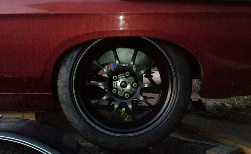

Very nice attention to detail on that safety wiring. You have it ran correctly for tension in the right direction. Seen a few examples where people didn't do it correctly.
Is that "AL" for aluminum, or just a designation? They look like steel. I wouldn't think aluminum would be good for a drive hub because of the lateral forces in corners.
It would be killing me not to hear that engine run. I think I would be starting it up every few days just to hear it run  :)
Thanks for the props on the safety wire job.
As for the drive plates yes they are aluminum.  Yes the Aluminum makes them a wear item that has to be replaced.  Kenny at Speedway told me for a street car you should run steel if you plan on a lot of miles.  The AL is a significant weight savings.  I may pick up a set of steel plates to run on non track days.
Bottom line is to inspect, clean and grease them regularly.  It's pretty easy.  Wheel off two allen head bolts remove the plate.  Even a cave man could do it.

I love the simplicity of that design. Lots of strength in a full floating design. And when you consider it a wear item, it's all good then...lol

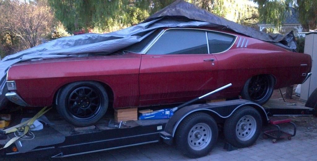

I got my wheels, studs and Lugs and am ready to take my car down to some shop space I have and drop the drivetrain in and start on all the little things that will keep me busy for months.
The picture is bad and the car is dirty but you get the idea.

Very nice Rob.  Looking at the jack and all that wood; how much fanagaling does it take to get that puppy on the trailer? ;)
Rolls right on and off.  I was swapping the front hubs and all the wheel studs so I had it on blocks.  Now I'm taking it over to a shop where I have some space to work and will start getting ti together.

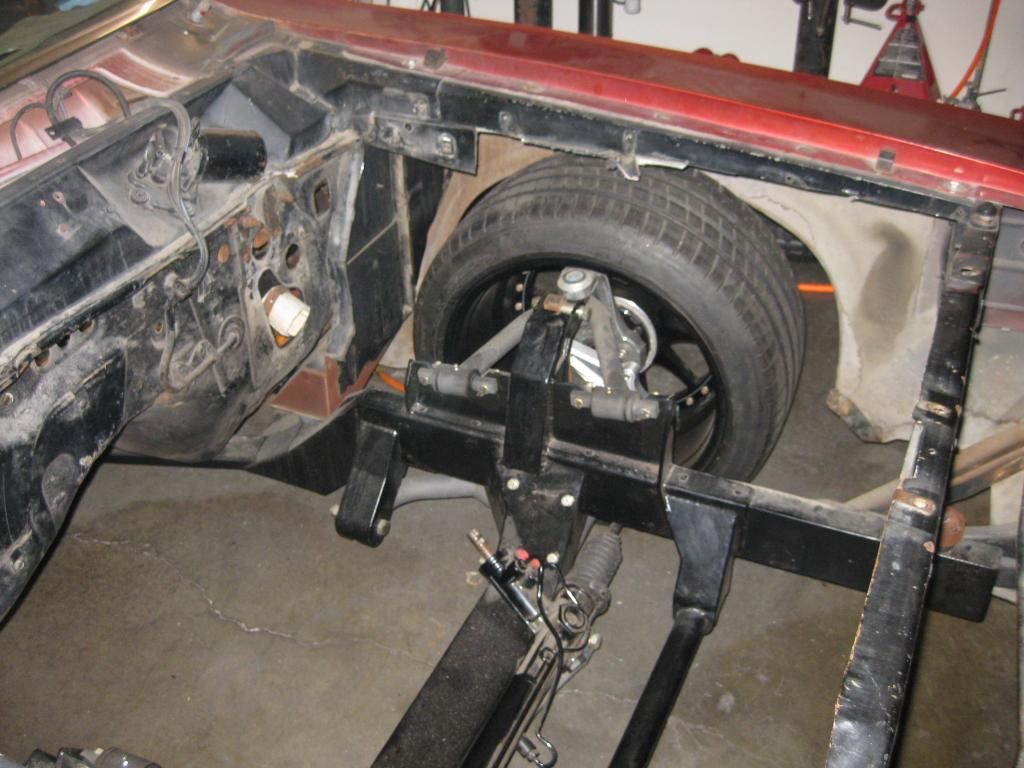

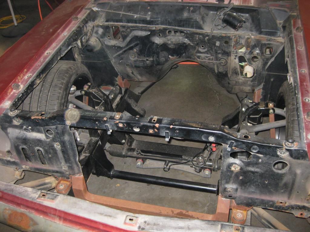

My apologies to the purists but these shocktowers don't do anything but add weight these days.
I'm getting ready to drop the TP and 6 speed in there.

« Reply #71 on: October 16, 2013, 06:34:42 AM »
Cool, you can upgrade to an SOHC at any time in the future  ;D
IMO shock towers were NOT one of Ford's better ideas...

Of course a SOHC would fit no problem in the "stock" location, I said stock referring to this car, hilarious...  I am planning a little firewall modification so the room between the footwells may be my biggest concern....... if you get where I'm going.

Are those rotors oxided, or are they carbon fibre?
