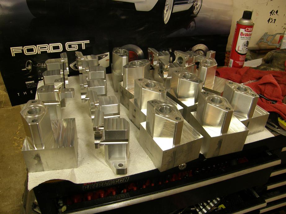

Looking back it is amazing to me that this took so long  :o  I expected to be finished with this stuff a month ago.  Oh well, I'm in production now; here's a shot of some complete and some partially completed adapters:
There is an ad in the vendor classifieds and a link under the Products and Services button on the main web site for anyone interested - Jay

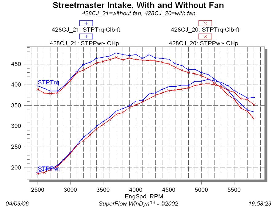

Ok so its roughly 10-15 hp gain for the electric pump. Any Idea what a SS flex fan or a non clutch fan uses?  From what I see 15-25hp can be gained from using both. Thats pretty cheap horsepower. I know the alternator will be doing more work but in a race car you can disconnect the alt for your quarter mile pass with a simple switch.  I remember my friend ha a car and we put a vacuum switch to disconect the ac compressor at WOT.
I did that test a long time ago for a guy on the FE Forum, but I can't find the data at the moment.  The test was somewhat suspect too, because the fan was just hanging out in front of the engine, not positioned right next to a radiator like it would be in the car.  But if I recall correctly the test showed about a 10-12 HP loss due to the presence of the flex fan.  For sure there's at least some horsepower to be gained by removing the fan...
Edit:  Never mind, I found it.  Here is the data:
« Last Edit: March 01, 2013, 02:18:50 PM by jayb »

looks like roughtly 20 hp to me. I recently installed a 4 core aluminum radiator and twin electric fans. I need an electric pump lol. That would raise my very dissapointing 415 rear wheel dyno results a bit. Since that time I went to a 3 inch magnaflow exhaust, Which feels like 100 hp over the flowmasters. and an 850 dbl pumper from a 750. I will probably find out at Beaver Springs Fe reunion what the 1/4 mile times are.
