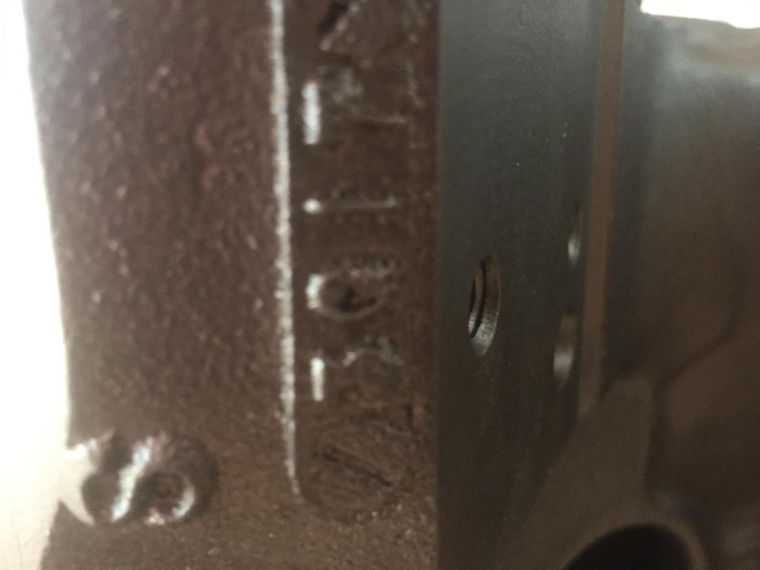

Just tore down a fe that is suppose to be a 390  Found 3u on the crankshaft is this a 390 crank?

3U- 72-76 390 truck.

3U is a 390 crank as said above
