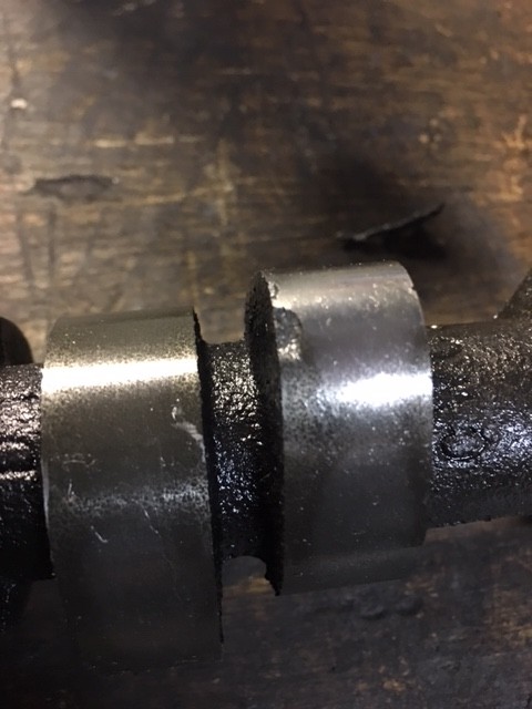

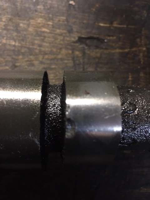

Inspected my custom Bullet solid flat tappet cam before stabbing it today and what a kick in the junk.  No idea what happened, It's a few years old now but not many miles on it.  Planned to use it in the EFI 461, I have a similar hydraulic grind, but I tend to like solids.  Need to think about plan B
This is the rear-most lobe on the cam, no other issues anywhere else.  Lots of casting slag on this grind compared to a comp, maybe it had something funky going on with the core, or I somehow missed it the first time.
Believe it or not, the small chunk scares me more than the big one, the lifter does not hit too hard on the big part, but over the top of the lobe you can see the path goes right over the missing small chunk.
That cam ran good, it's a shame, and Bullet stuff is priced OK but not cheap

Yeah Ross that looks like a casting flaw on the edge and based upon the location and color, maybe you missed it as it doesn't look like stray material took out that chunk.

Witness marks on the other lobe makes me wonder if it pulled off a rack (at Bullet?), caught something, and smacked the side of the right lobe.

I think the casting look verry rough between the lobes like
some Russian casting, maby it just the pics but ???

Most domestic camshaft cores come from CWC Textron, and will have "CWC" cast into the core somewhere.  The raw castings are flame hardened on rollers over gas jets and then sent to a couple places - Camshaft Machine Company (CMC) in Jackson, MI or Engine Power Components (EPC) in Gran Haven, MI - where they get the bearing journals finished, front and rear end surface features drilled and turned, distributor gears robbed, and lobes rough ground.
At this stage, the cams are referred to as "UGLs" - unground lobes - and will either be finish ground and packaged at CMC or EPC for a multitude of private label companies, or sold to the various cam grinders for use in making custom cams.  Each UGL part number has limits as to how far you can go in terms of grind profile and lobe placement on a given core before you run too deep into the hardness layer or run "off the map" of the core's physical area.  You cannot always "make anything you want to".  If the hardened layer is too shallow to support the load it might chip or wear prematurely, if you are trying to use all the possible real estate on a certain UGL you might leave an untouched spot if the cast is not 100% perfect and the flaw don't get caught....

This one is a baby though, although it was wide LSA that could cut one side of the lobes a little deeper. Although that lobe should be the exhaust opening side, which would be the deeper cut side for a wider LSA
It's 271@.028, Bullet called it a 282S copy, I'd buy that using Comp's .015 rating, although I never measured .015 events, its 236 @ .050 and .586 at the valve
It's just the one spot, but it doesn't look like external damage, so you are likely onto it.  Quite honestly, it could live forever, or in the new block it could die instantly LOL  Murphy's Law now that I see it though

i like investigating things like this and i agree with Felony.the scratches to the left of the chips line up.i think it scratched and then dropped to the next lobe and chipped.there is even a scratch on the other side of the chipped lobe.the lifter might have smoothed out the center.
Well-honed intuition is a wonderful thing. Just ask doug.  8)
