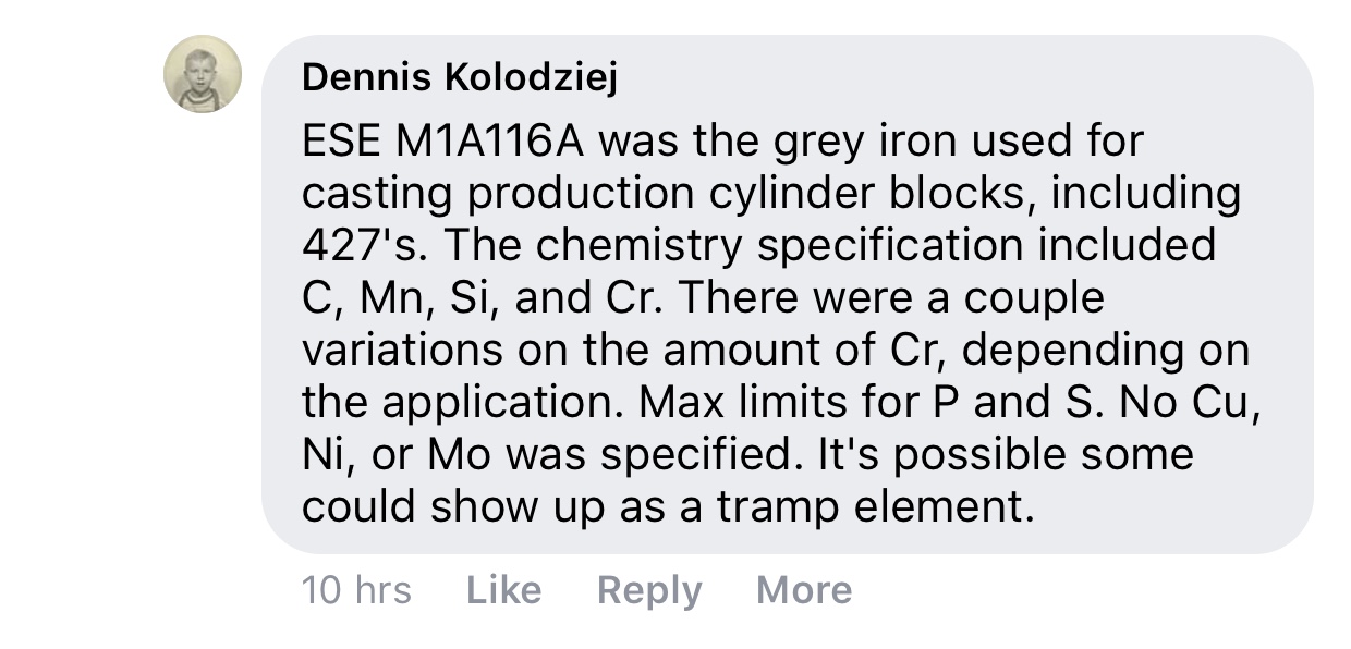

Adding nickel to the casting would just make them harder to machine, require more expensive tooling and such.  Not likely a common thing that would be introduced on a production line, more like one off special runs handled elsewhere.  If I had a nickel for every time I'v read about high nickle blocks on the web...

The subject continually comes up on the FE Facebook page, thankfully with the help of Dennis K. who worked at Ford and has researched the subject and checked the engineering specs it’s been proven to be false in the case of FE production blocks, including 427’s. This includes all the old stories of the “X” on certain blocks signifying high nickel, etc. And yet probably a week doesn’t go by where someone doesn’t chime in with some convoluted story of how they know it’s true. Here’s this weeks answer from Dennis regarding the question:
