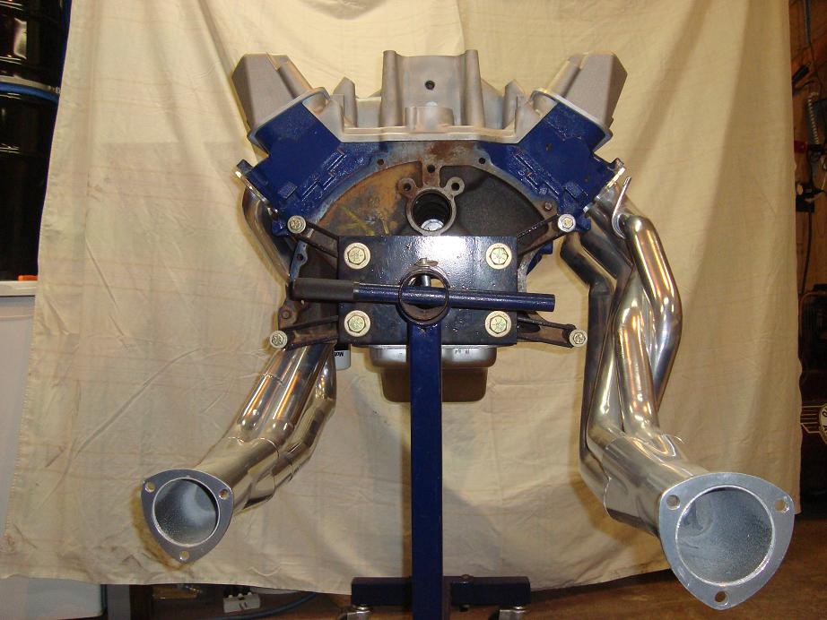

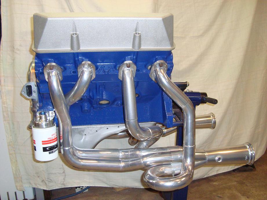

« Reply #1 on: November 27, 2018, 10:15:13 PM »

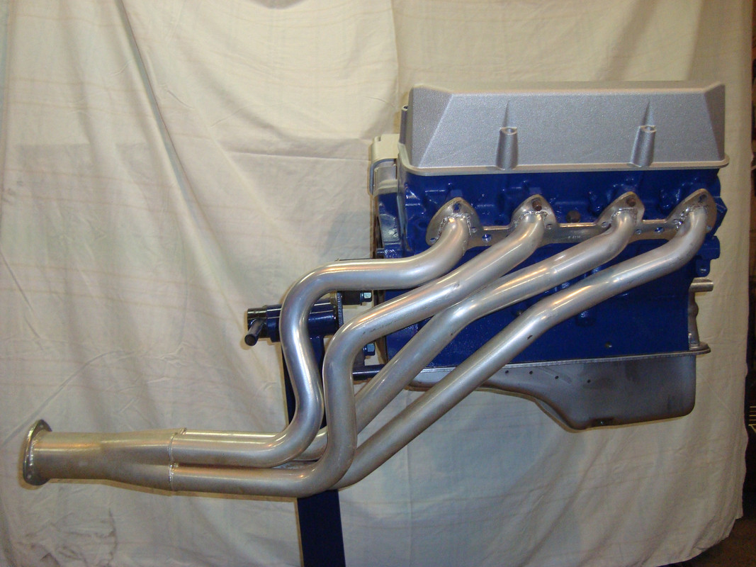

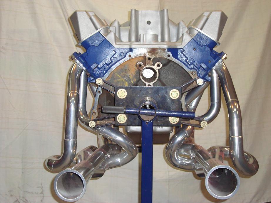

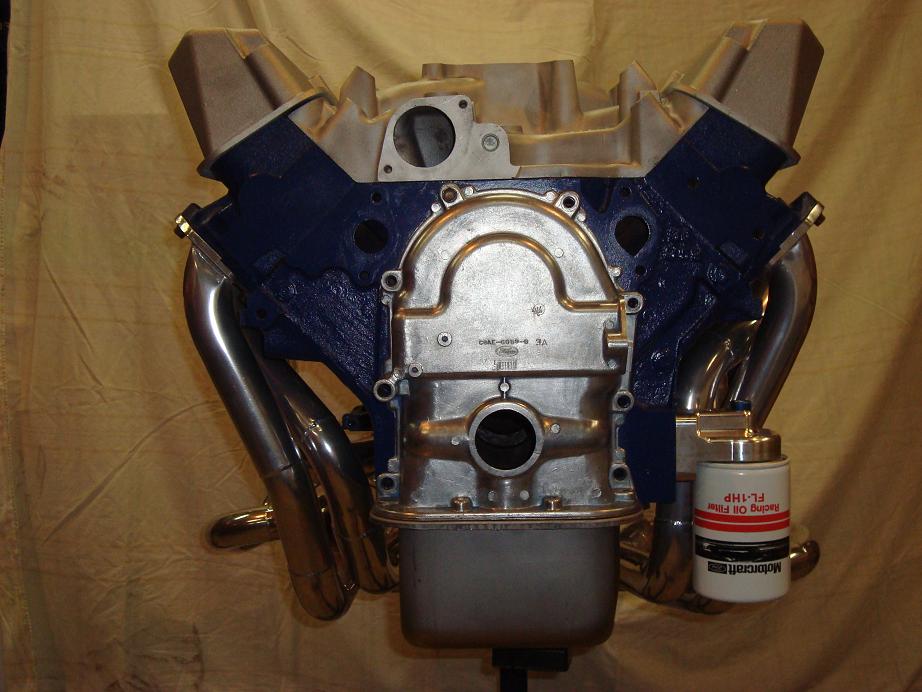

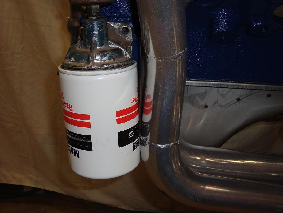

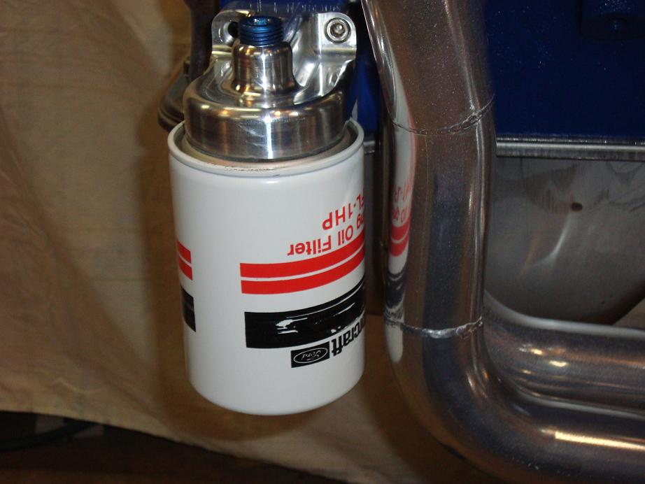

Here are a set of REF headers I have. REF in Kingman Arizona makes these headers to your order, so they aren't just a universal part. These were spec'd for a 390 Stock Eliminator '67 Mustang/Cougar drag race application, with an automatic. REF would make them differently for example if it was for a 428, or a stick shift, etc. These are 8 individual tubes that slip into the collector. They will ask about the specific heads you're using, these were made for an 8 exhaust bolt hole head, they can do other patterns. As you can see these won't fit a "T" style oil pan, but info from Doug's recent question sounds like they can make those too. The O2 sensor bungs were an option. I had the V-Band clamp flanges welded on after, since I plan to also use these on Dragweek with exhaust occasionally. I also had them coated locally. Best idea for anyone interested would be to contact REF directly about what they can make, price, etc.
Here shows an issue I found, the standard FL1 style oil filter will contact the forward tube of the header with a stock Ford oil filter adapter, which angles slightly rearward, I am going to use a Precision Oil Pumps oil filter adapter that points the oil filter straight down, which clears then. There's enough tolerance to just get the stock filter to fit, but it touches, with some modification a person could make the Ford filter adapter work.
The stock Ford car filter adapter.
« Last Edit: November 27, 2018, 10:17:01 PM by thatdarncat »

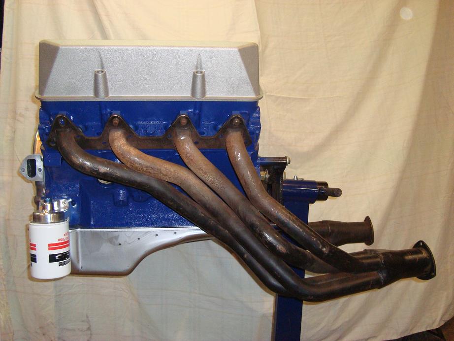

« Reply #2 on: November 27, 2018, 10:39:10 PM »

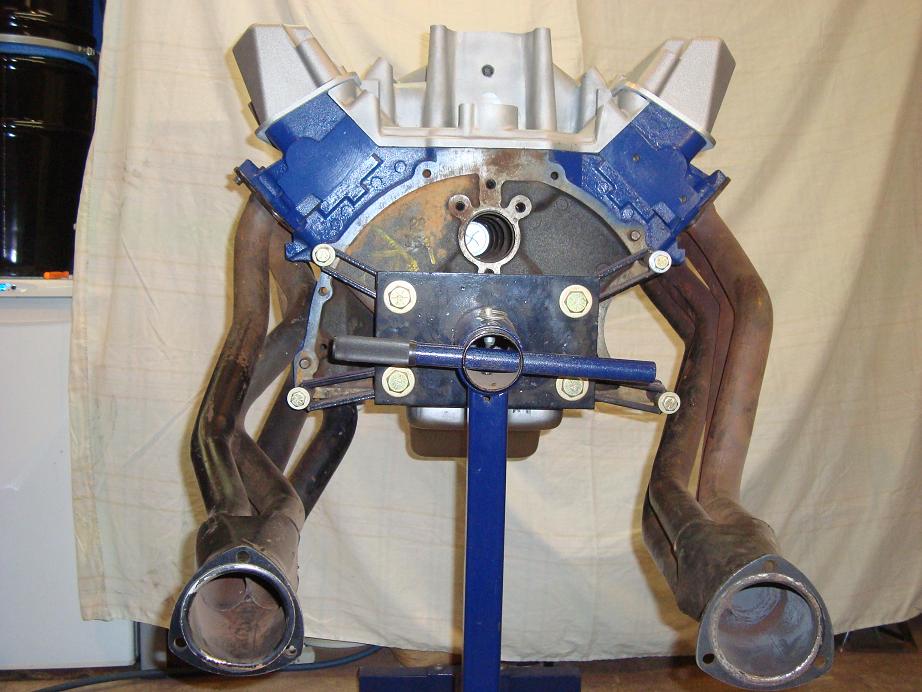

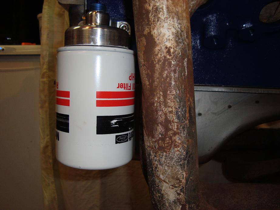

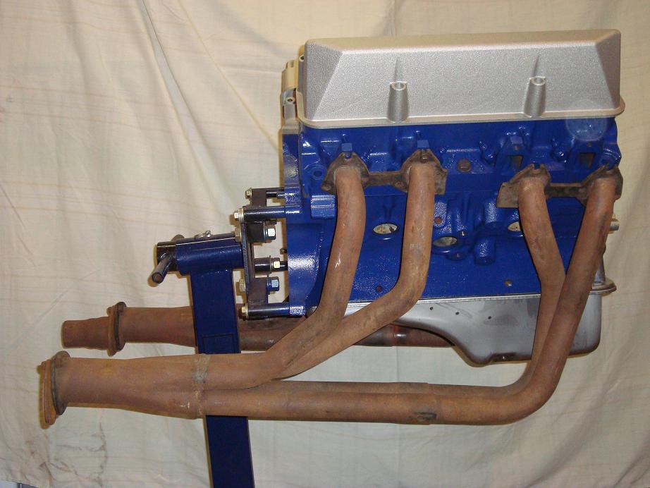

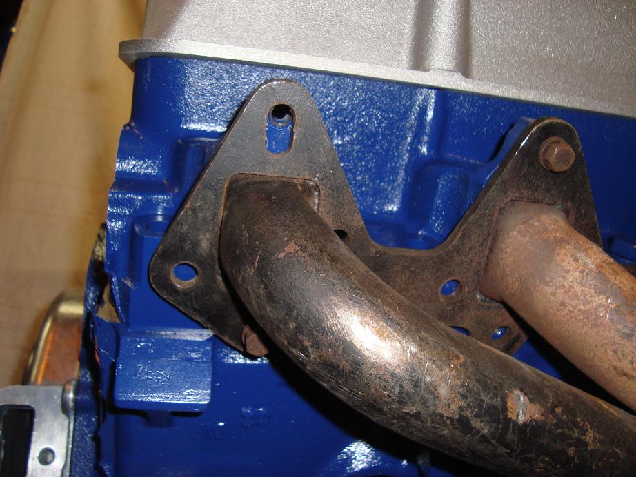

Here are a set of Hooker 6113 Super Competition headers. Application is '66-'69 Fairlane/Torino/Comet, also some Falcon. I bought these back around 1981, I'm not sure if Hooker has made any changes to these over the years, maybe someone can comment? I had them coated. The drivers side header is a two piece, with a slip fit. I specifically bought these at the time since they would work with the factory clutch linkage. They will not work with a Mustang/Cougar style motor mount on the drivers side, no room to bolt to the block.
One issue with these was the stock Ford oil filter adapter would not fit with the forward tubes. As you can see in the pictures you can fit an oil filter on with the Precision Oil Pumps filter adapter, but the filter is very close. A person may want to check the smaller diameter style oil filter. When I used these I had a remote oil filter set-up.
The collectors on these end at different points due to the pipe layout.
These have slotted upper end bolt holes in the flanges to fit either the 8 bolt/16 bolt exhaust pattern, or the 14 exhaust bolt shock tower head pattern. I don't know if Hooker still makes them that way.
These have the Hooker 6113 part number stamped in them on the flanges and the Hooker logo stamped in the collectors.

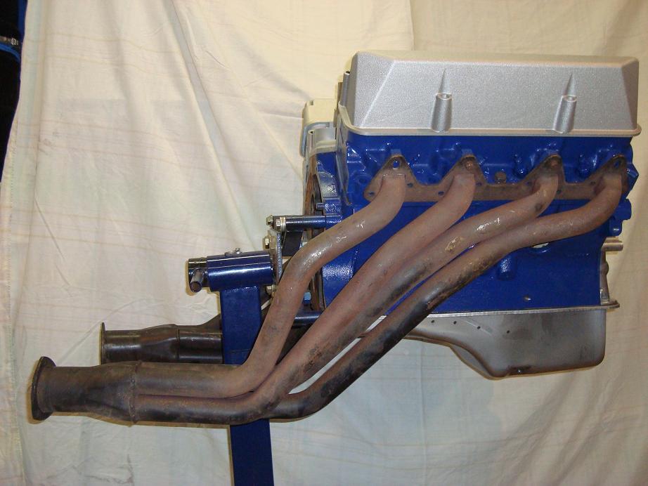

« Reply #3 on: November 27, 2018, 10:56:09 PM »
Here's the passenger side from a Hooker 6114 Super Competition set. Unfortunately the drivers side of this set I have got bent in an careless trailer mishap. The application for these is Mustang/Cougar. Both sides are single piece header. I bought these in the late '80's, if I remember. I think they have "Mexico" stamped on the flanges, along with the part number. Originally they had a "Hooker" tag spot welded on. These only have bolt holes to fit the 8 exhaust bolt pattern, or the 428 CJ style 16 exhaust bolt pattern, they were not slotted to fit the lower top end bolt holes of the 14 exhaust pattern of the shock tower ( GT ) heads. I modified these to fit the 14 exhaust bolt pattern by drilling extra holes, there's a picture of that below. These had to be welded on the flanges eventually when they started to rust through. You'll notice the passenger side header is similar, but not the same as, the single piece side of the Hooker 6113 Fairlane header. I had these coated.

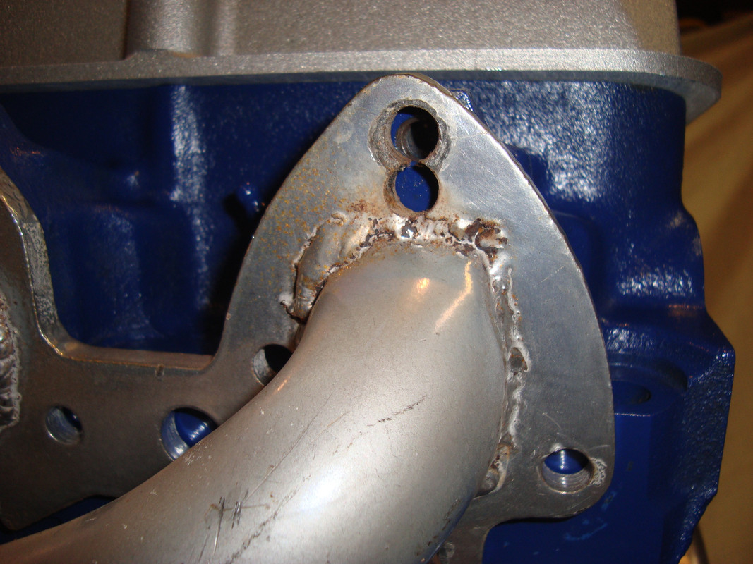

« Reply #5 on: November 27, 2018, 11:56:46 PM »

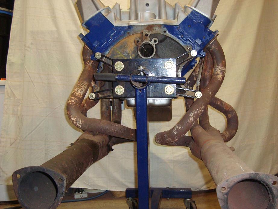

Here are a set of Cyclone brand part number #10647 headers. The application was '67-'70 Mustang/Cougar and '66-69 Fairlane/Torino/Comet. I bought these in about 1980. Unfortunately when I bought them through my friends shop back then we didn't notice the notation in the catalog that they would only fit automatic transmission, and not manual transmission vehicles. You can probably see there isn't room for the stock clutch linkage with these. An issue you can note in one of the pictures also is that one of the tubes is right on the back corner of the block. These are mocked up without gaskets, with a gasket they might not touch, otherwise a person would maybe have to clearance the tube or block to keep from rubbing. I should note too, most of these headers including these, won't fit with the original Ford power steering cylinder unless you get an optional drop bracket, if they will fit at all. There isn't any part number or brand logo on these.
Where the tube hits the block
These actually have nice slotted upper end holes to use with either the 8 exhaust bolt/16 exhaust bolt hole pattern or 14 exhaust bolt shock tower head pattern. Seems to me some of the other bolt holes are not fun to get to though.

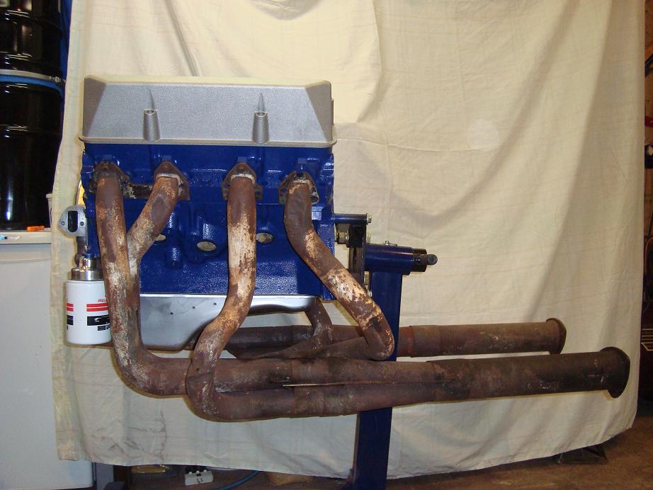

« Reply #6 on: November 28, 2018, 12:18:39 AM »

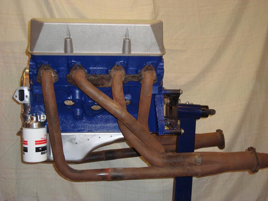

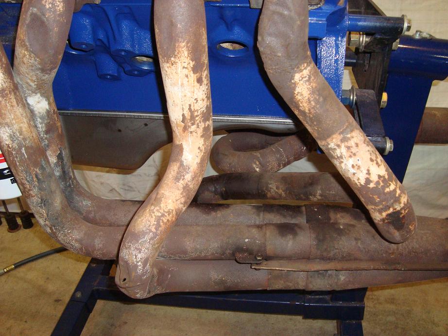

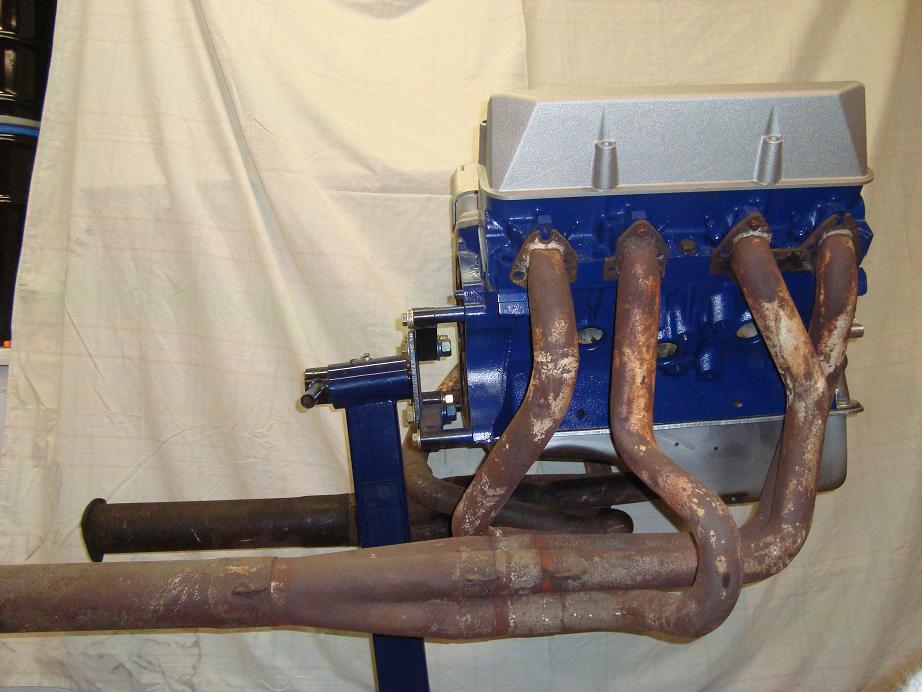

These are a set of FE headers a friend gave me. I have no idea what brand they are, or what they are supposed to fit. If someone recognizes them let me know. They have no brand logo or part number on them. They are two piece on both sides - one forward tube slips into the other part on the drivers side, the two forward tubes slip into the rest on the passenger side. These are a little tweeked on the passenger side, and the two forward tubes are also rusted in place, so I wasn't able to fully bolt these up to the passenger side head, but I think you get the idea. Also, I could tell a couple of these bolt holes would be near impossible to get to.

On the "no idea what brand" ones, they almost look like Crites/MadDog but I don't think they have just one left tube under the crossmember like that though.
