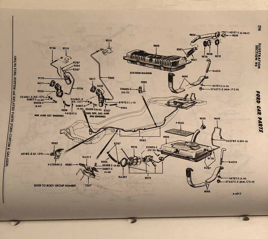

Any one who knows, whats the difference stationwagon/ not stationwagon
gastanks on 64 Galaxie. What i can see on the pictures its only the filler tube.
Easy to replace if the rest is the same,the stw tank is so much cheaper so worth
the job

I don’t have any first hand knowledge on that one, but looking at the diagram in the Ford Parts book the shape of the station wagon gas tank seems to be different, along with the location of the filler neck.

Here is a wagon tank from my '62.  I'd be surprised if they were different than a '64.

Problem is i need a car tank not station wagon, and i see it is totaly different
In the  pics they have that sell them, they dont look like that.
Wrong tank in the pics i guess ::)
Well you have to pay to play i guess
