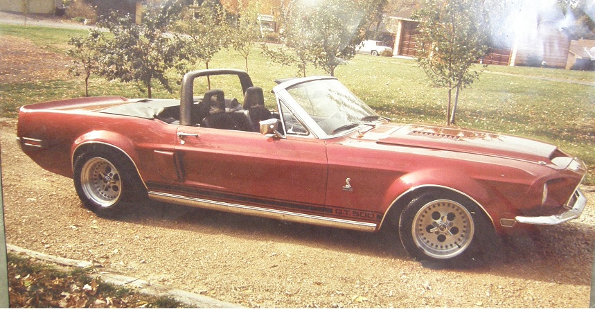

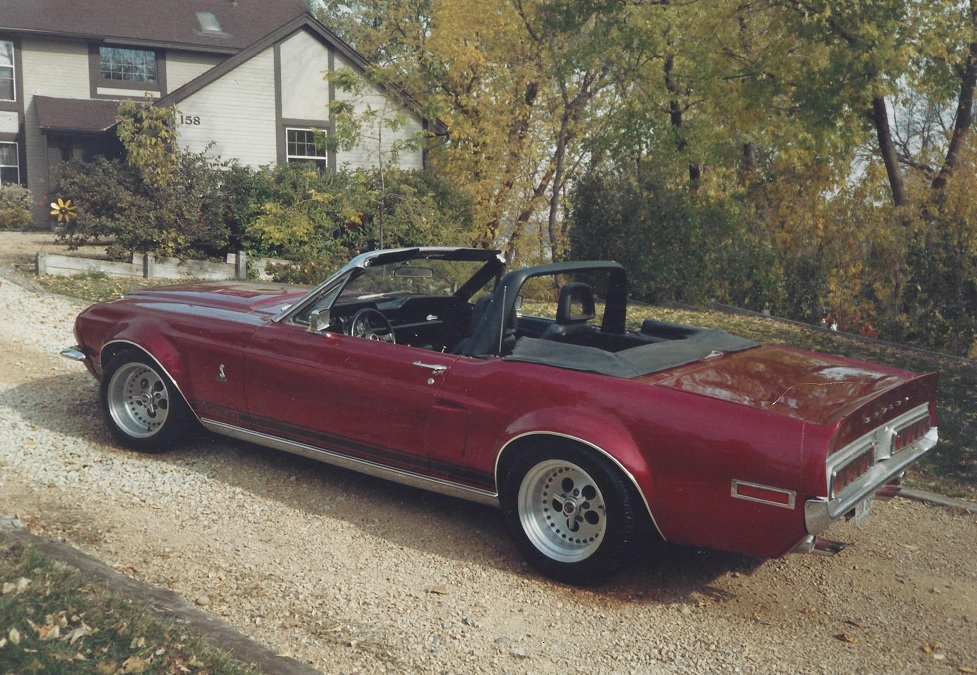

If memory serves it was late summer 1984 when I finally got the car back on the road.  Looking back, I really regret not taking
photos of the car when I first got it, or anywhere along the way.  In fact I have no photos of the car that I took.  However,
after I got it done in 1984 I brought it over to my Dad's place and he snapped a couple of pictures.  He then had them blown
up into posters for me as a present.  The pictures are below; these are 2 of the only 3 pictures that I have of the car from
back then:

Fast forward to 2003, and my kids were old enough to be left alone in the house.  The car was waiting patiently for me in the
garage, and I decided now was the time to get to work on it.  It still had rust holes in the floorpan, the inner rocker
panels were rusted out, and the bodywork around the fender flares was starting to show its age.  I was done with the Cafe
Racer mentality, but still being a hot rodder at heart, I wasn't going to return the car back to stock.  However, my new
concept for the car was to return it to a stock appearance, maybe a little lower in stance, but upgrade the engine for
more power.  I was also tired of jumping over the side bars across the doors that had been added 20 years before to keep
the car straight.  So, it was clear a ground-up revamp of the car was necessary.  Fortunately all the sheet metal parts
needed to repair the rust damage on the car were now available, so I figured with the necessary floorpan, inner rocker
panel, and torque box replacements I could cut those side bars out and get in the car like a normal human being again.
In the fall of 2003 I put the car up on jackstands and tore it down.  The engine, which had been running fine, came out
and was put on a stand.  The interior was removed and I started drilling out spot welds and removing rusted out panels.
But the work was slow going, and I absolutely, positive, HATE sheet metal work, so I did a little at time through the
fall of 2003 and winter of 2004.  I got the passenger side finished up, with a new front torque box, new rear torque box,
new inner rocker panel, and new floor pan.  I also got started on the engine project, which included a Shelby block, Blue
Thunder heads, and a Vortech V7 centrifugal supercharger.  In the spring of 2004 I went to the dyno with that engine and
made 850 HP.
Then, in the summer of 2004, a freshly painted 1969 R-code Mach 1 showed up on ebay.  It was complete - except for the
engine.  Of course, sitting on the stand next to my Shelby was a complete, running 428CJ.  Hmmmm, I always wanted a 69
Mach 1...
The Shelby was suddenly forgotten.  I bought the Mach 1, slammed in the 428CJ, and drove it all summer.  The next year I
put in a bigger engine and went to the first Drag Week.  In 2007 I put the supercharged engine originally meant for the
Shelby in the Mach 1 and ran a different class at Drag Week.  Somewhere in there the cammer bug bit me, and before I knew
it 14 years had gone by.  The Shelby was still sitting up on jackstands in the first bay of my shop, with half the floor
replaced, waiting to be finished.
At the beginning of September we got my son sent off to college, so the time window has opened up for me a little bit.  My
wife has been bugging me for the last couple years to get my Shelby put back together; she isn't into the car thing much,
but when we were first dating she did enjoy driving around in that car.  So, now is the time.  Here's a picture of the car,
warts and all, as it sits in my shop today:
I've been working on it for the last week and a half, and now the driver's side floorpan, inner rocker panel, and rear
torque box are welded in.  I'm currently welding up all the holes in the engine compartment that I put in there over the
years.  When that is finished I have a partial frame replacement to do on the driver's side, back by the rear leaf spring
mount, and then I will cut off the quarter panels and fix the outer wheelhouses and trunk drop downs (they are completely
rusted out).  In about another two weeks I have a guy coming here to do a complete dustless blasting job on the car.  Then
I will epoxy prime the whole car, replace the quarter panels, and finally be done with the sheet metal work!  Meanwhile,
all the fiberglass parts are out getting plastic media blasted.  When they are back I can finally start the bodywork.  I'm
hoping I will be able to get the car painted in the spring.
