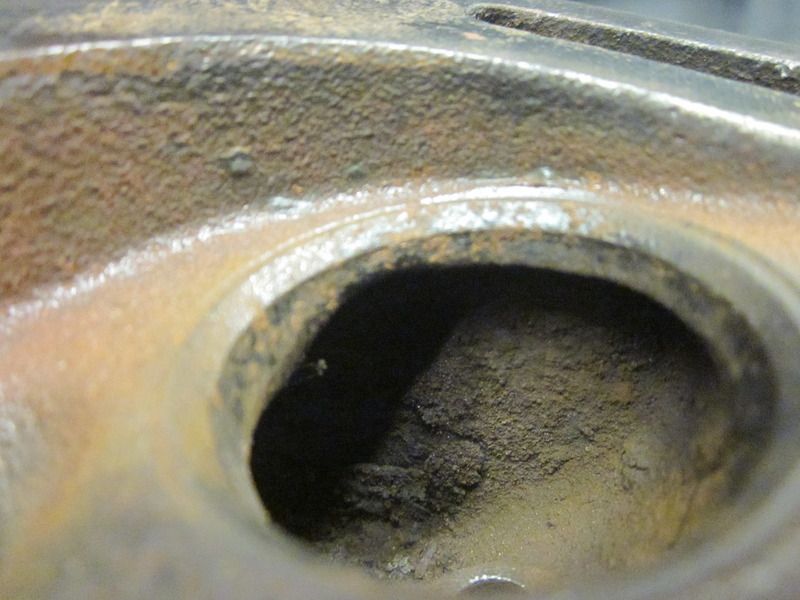

This is the only photo of 2 marine engines available for sale. Is this a 427 fe? If so is this a desirable block?

It sure looks to be as you compare these photos:
https://www.google.com/search?q=chris+craft+427+ford&rlz=1C1SAVS_enUS541US568&source=lnms&tbm=isch&sa=X&ved=0ahUKEwjpveHO78zTAhWI7CYKHSD-DygQ_AUICygC&biw=1024&bih=490
It's possible at some time that a 390 short block was swapped in. Best bet? Yank intake and one head. Measure one to bore.
A stock bore 427 has a bore size of 4.23".
A 390 has a 4.05" bore.
