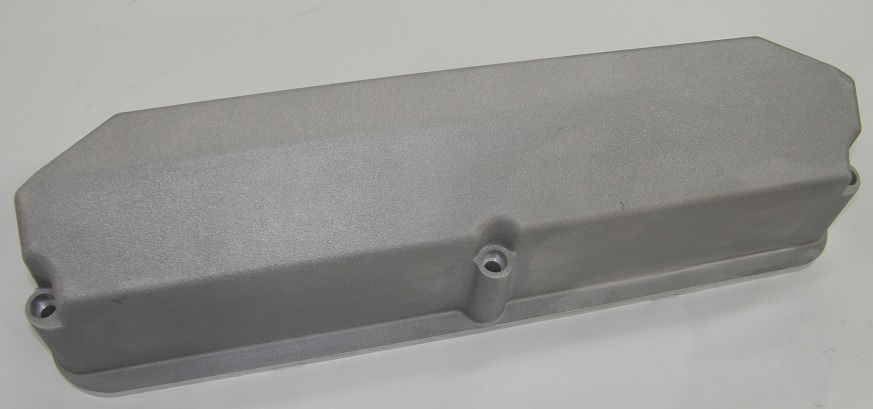

Been burning the midnight oil on the CNC machines, trying to get the valve covers ready to show at the Back to the 50s event at the Minnesota State Fairgrounds this weekend.  Just finished up the fourth cover, so I thought I would post some pictures.  Here is part number 17004, which has two breather holes, one filled with a screw-in cap, and the other with a screw-in breather filter:
Here's my favorite, part number 17005.  This one is engraved on the top.  I expect to be able to do custom engraving on any of the covers:
Also, some shots of the underside.  You can see the ridge around the outside of the cover to hold the gasket in place.  Also, the machined area underneath is a breather relief.  Around this area are four small tapped holes.  There will be a steel baffle plate that screws into the holes and extends out towards the end of the valve cover.  The idea is to get the baffle past the last rocker arm before it opens up, to prevent oil splash up in to this area.  Also note on this cover that both breather areas are machined, even though only one breather hole is cut into the cover.  I'm going to machine all of them this way, even the ones with no holes, so that people can put their own holes in the covers if they want.  I expect to be offering them with the screw-in style holes as shown in the photos, or with a 1" machined hole for a push in breather, depending on what my customers want.  But there may be other potential openings, so making the breather reliefs and baffle plates available on all the covers will open up all the possibilities:
Here's a couple of shots of the plain cover.  This is the one I'd expect to be selling for $259:
Last but not least is the cover shown below.  This one took quite a bit of time to machine, and the clear polycarbonate cover took some time to cut also.  And, I'm going to have to test this one because I'm not sure the O-ring seal is 100% reliable.  I'll get it on the dyno and check it for leaks sometime soon.  Hopefully it will be OK, because I think this one is pretty cool:
And here's a shot of all of them together:
Overall I'm pretty happy with these valve covers.  There are a couple of issues I have to address with the foundry, in terms of the surface finish, and also the cleanup they do on the covers (one of them showed evidence of a light touch with a sanding wheel, which they probably use to clean up the risers at the bottom of the casting; I have to make sure that the foundry knows I can't accept covers with any sanding marks on the outside surface).  Nevertheless, I think those issues can be easily addressed, and am still hopeful I can be starting to deliver these in 8 weeks or so.  I'm very curious to see how they will be received at the big car show this weekend...

nice Jay I think the clear cover is cool what do you think the life expectance is on the top as far as seeing through it , or after a year or two you buy new tops.

I was going to mention the surface finish, but didn't want to sound like I was nit-picking. They don't look like the quality of finish on the other parts you produce. Hopefully they can clean them up a bit.Still...looking good. Can't wait to get a couple sets. I really like the baffle idea. Will the baffles come with the covers?
I hope not, the clear covers should be good for the life of the valve cover.  Again, I need to test them to be sure...
I'm used to your nit-picking, Doug ;D ;D  Turns out that the foundry used the wrong sand for the outside surface of the mold.  I had specified a very fine sand, to try to make the finish very smooth, but somehow between the main office and the foundry floor that message got lost.  They will be casting a few more prototypes for me before I place the production order, to make sure that the surface finish issue is addressed.
The baffles will come with the covers, I just haven't gotten them produced yet.  As far as the oil caps and breathers, I will supply those.  I have to buy them from a certain manufacturer and make a modification to them so that they will work with the covers, so they won't be available elsewhere.  The caps will add $15-$20 each to the price of the valve covers, and the breathers will be somewhere in the range of $30-$40.

There are 3" long allen bolts and washers that will come with the valve covers.

Jay, I don't know if you know this, but if you take a butane torch to the edges of the polycarbonate after it is cut to shape and gently bring the flame to the cut edges, it will clear up like the top, and you won't have to sand or dress the sharp edges.  Takes a little practice, but the results are worth the effort.  Joe-JDC
