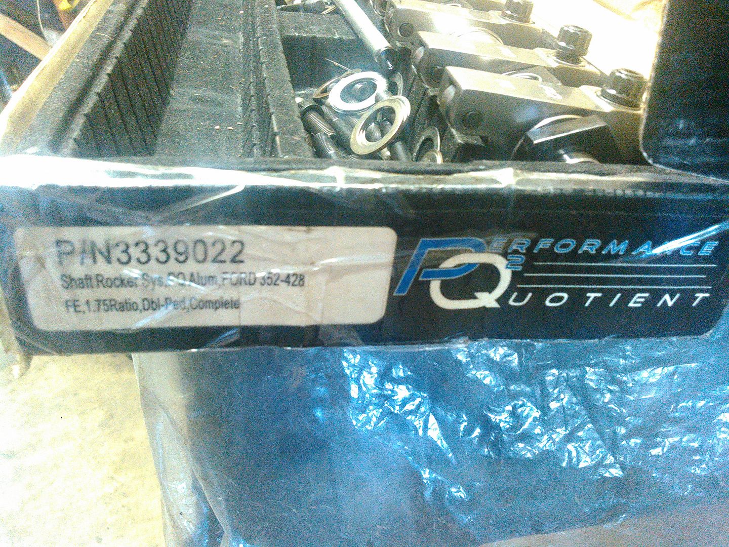

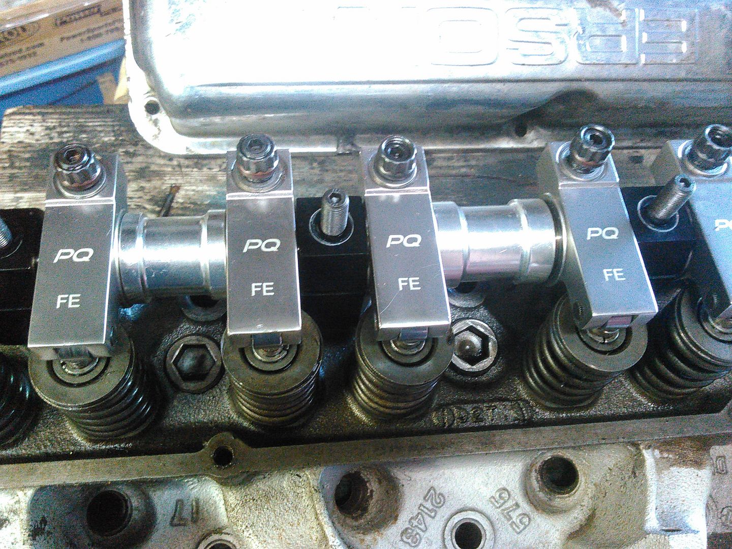

Thank You Gentlemen:
 But Re: "If you have clear evidence you will sometimes see a corresponding +/-5psi drop in oil pressure as the parts separate."
Just checking because I have a sideoiler that is oiling my rocker shafts through the stands - not the pushrods, as numerous exotic rocker support systems do.
   I can see the both the top and bottom pushrod tips loosing oil if they were oiling but production FEs and my side-oiler feed oil through the stands.
