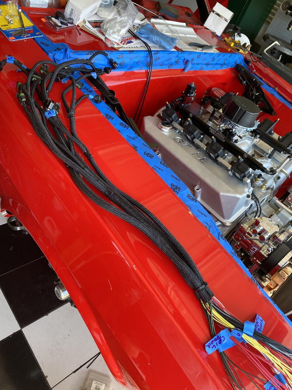

That is awesome!  Nice, clean installation, will look great with those 8 coil wires looping over the valve covers.

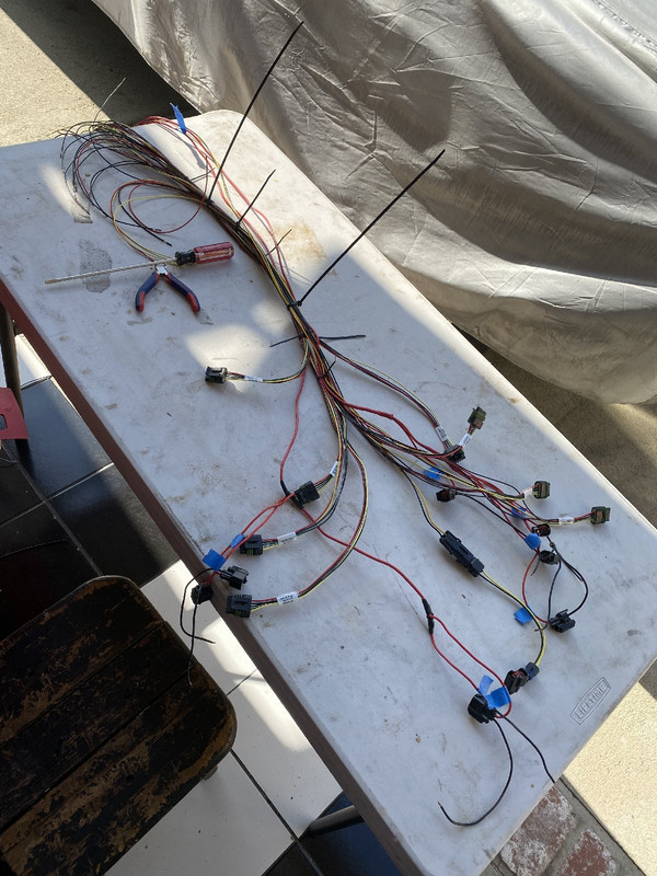

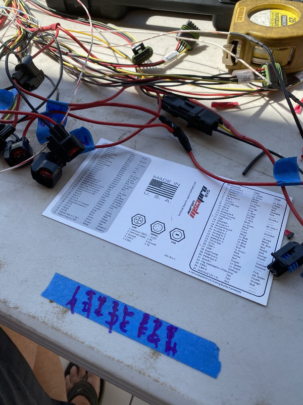

Pulled the mocked up engine harness out and got to building it. Started at the end and worked my way back toward the firewall until all 8 were covered. Then put it back on the car to make sure it still fit. While it was on I could now get an idea where the bulkhead connector would be. Marked it and took it back off the car. Now just waiting for the connector. I really hate to go through that beautiful firewall but I’m going to pop it through at the bottom just before it turns under the car. That way you can’t see it from most views of the engine room.

I use shrink hose on the end of that ....harnes sock or whatever it is called ::) so it stay in place and not fray
