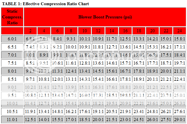

Jay is right.  8.0:1 is about the max you can run if you want to push 6-8 lbs of boost with a positive displacement blower.
Here's a chart that gives a really rough estimate of equivalent static compression for boost and engine compression ratio:
From this article:
http://www.jegs.com/tech-articles/superchargers.html
Screw-type Eaton blowers are a bit more efficient and can tolerate slightly more engine C/R, but the above info gets you in the ballpark.

« Reply #8 on: July 01, 2016, 03:32:09 PM »
So based on the chart Bill Conley posted on E85 you could run 8 plus pounds of boost at 9 to 1 static. Don't know how available it is to everyone but here in West Michigan they brew it locally. Next next FE to run will be E85 only.
