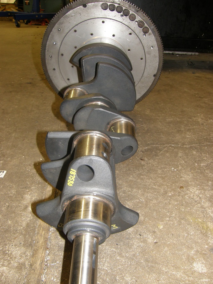

I agree on the bolt holes, but if what you said is correct about it bolting on only one way, then I don't know why you would be having that vibration.  I took a 428 flywheel that I have here and bolted it to an aftermarket crank, and took the picture below.  If the aftermarket crank has its bolt holes in the same place as the stock cranks, then from the picture it would appear that the flywheel weights are right at the top of the flywheel on the number one or number six firing stroke.  Note the position of the weights, and the keyway cutouts in the crank:

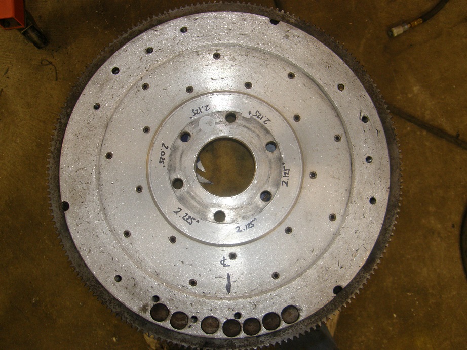

I also took the picture below after measuring the center to center distance of the holes on the flywheel, in case that would be helpful:
Note that one of the six holes is shifted on the bolt circle, causing two of the dimensions to be different than the other four.
Good luck on finding the problem - Jay

The picture tells me what I want to know the fly wheel weight lines up with the rear counter weight.
