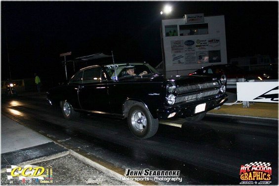

Pics are in! Probably not the best launch of the night, left lane had more traction, and a day time shot I am sure would be easier to make out but it is what it is and there does appear to be at least a bit of air under both front tires. That little Pontiac with a 4 cylinder turbo was deceptively quick yet I was a car or two ahead until it came time to shift and I had to let off the throttle. He had red lighted so I'd won the race but he did over take me at the finish line because of the trans issue. Launches were all very straight so now it is time to practice and tune and practice and tune some more.

I think I'm seeing some air. Great Stuff!!! ;D
No helmet?

Night racing tip...when getting air under the tires!
Take apiece of white tape, first aid stuff is best, and wrap a piece at exactly the 12 o'clock position on the steering wheel. Be sure that tape is exactly straight up when those wheels touch down.
No helmet?
Helmets are not required in the Street Legal Series or at least not with my current times. Maybe if I dip below 7.50 then it may be? I'm not sure. I am fortunate to live in one of the few states that still permit you to ride a motorcycle without one as well, communistic in every other respect but that is another subject.
Thanx machoneman, White tape sounds like a very good tip! Especially given that from inside the car I had no idea that the tires had ever left the ground.

I think when you start lifting the wheels, lids are required. jmo
It has a different "feel" with the helmet on also.
